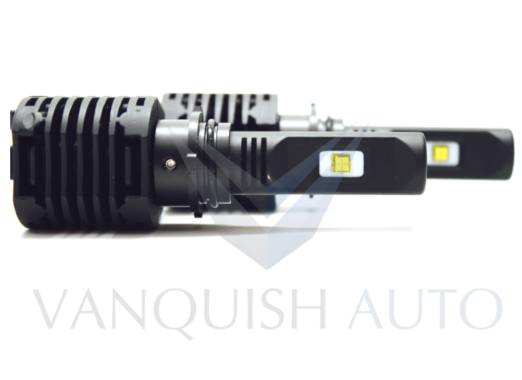

The 50w CREE LED lights consist of 10 x 5w LEDS (2 on each of 4 sides and 2 on end). The 80w PHILIPS LED lights consist of 8 x 10w LEDS (4 on each of 2 sides). See photos below for comparison.
Conclusion: Installation of both lighting options is quite easy. Most people will not find the need to remove any parts other than to just swap out the lights. There isn't a ton of space to work with but it can be done, see alternative installation options below. The only additional step required when installing the 80w lights over the 50w is that you will need to secure the 80w LED controllerso that it does not move around, see details below. The 80w lights are significantly brighter and are made almost completely of aluminum to help dissipate any heat. Even though the 80w lightsare brighter, they will also be less intrusive/blinding to oncoming traffic due to the LED orientation within the lamp, see details below.
