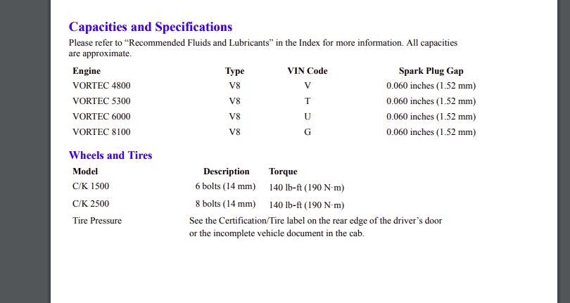

2002 Tahoe...i am confused!! I look at multiple vin decoders and one says my engine code Z is a 4.3, the others say 5.3!
How to i find a site that is accurate??

If the 8th digit of your VIN is "Z" then, unless it's been replaced, you have an L59 Flex Fuel 5.3L engine.
26,136
39,108
like noted above
the 8th digit denotes engine
most popular is vin T (5.3), if it is a 4.8 then it will be vin V
vin Z should be flex fuel 5.3, my 05 is a Z but I don't think it has flexfuel capability
