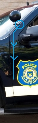

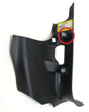

Has anyone had a water leak from where the spotlight is mounted? I removed the kick panel where the hood latch is and the panel had water in it. The spotlight is the only area I think it would come from. The water collects on top of the retaining clip:

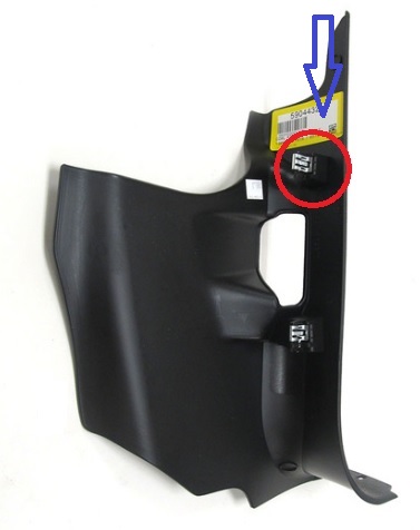

This the only thing I can think of, comes down and settles on the kick panel
