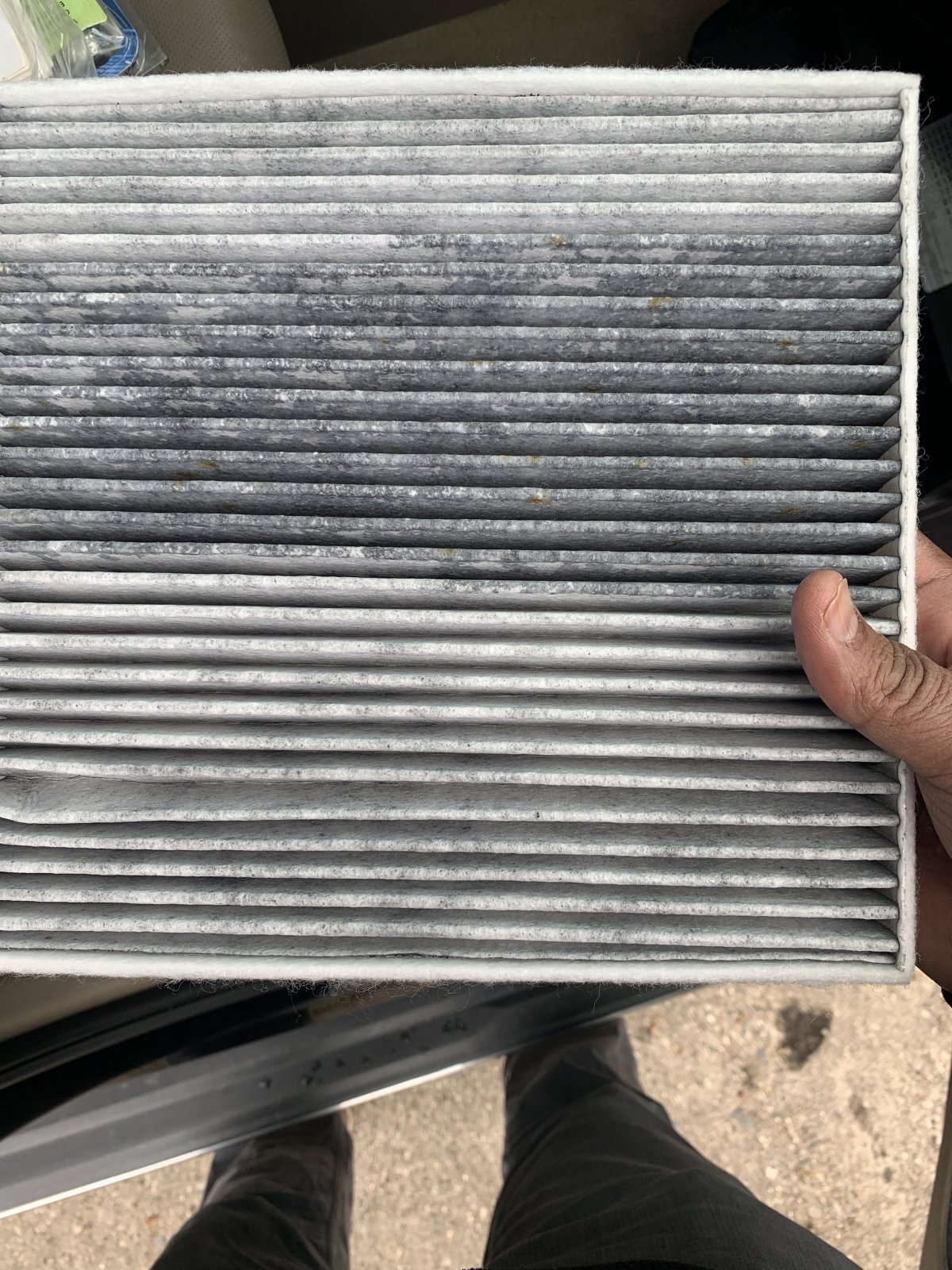

OK. So here is some more detail. I changed the cabin air filter yesterday (let's call this day 1) evening. Brand new, dry to the bone out of the package (of course). Since I changed the filter, we had rainfall last night and this morning (morning of day 2 about 16 hours later) It wasn't hard rain but it wasn't a drizzle either. Since I changed the filter I have not driven the vehicle one inch.
After I posted the original note, I thought I would check the cabin air filter to see if it is wet. Low and behold, it was wet in a portion of it. See picture. Inserted into the filter assembly, the wet portion would be to the left side of the filter and this coincides with the air intake (I believe) for the cabin.
Any thoughts or guidance on if there are already solutions out there to fix this? Or do I need to go through the whole 9 yards of testing with water?

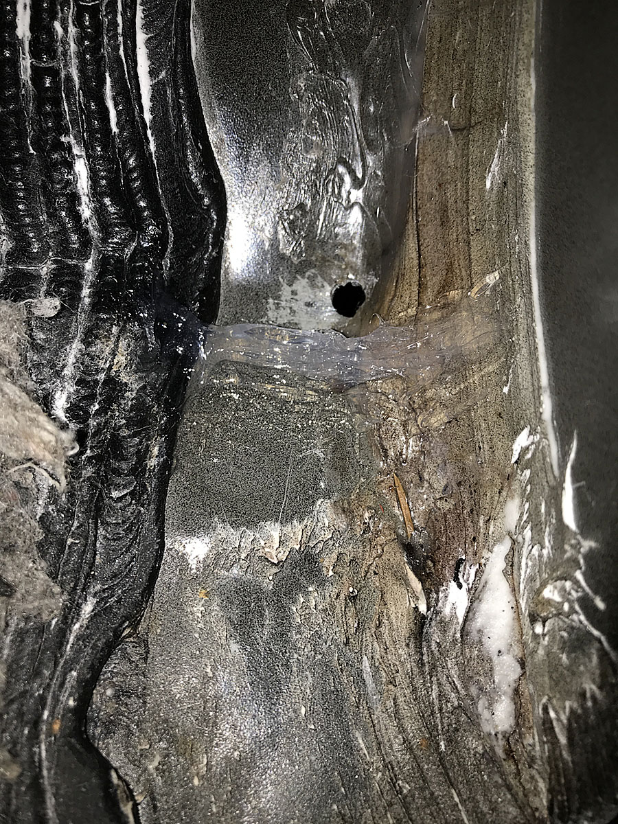

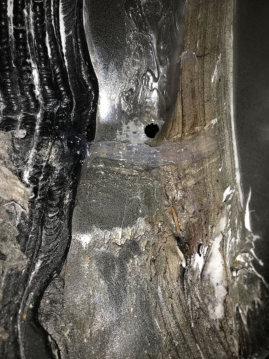

Here's my experience (I'm sure you'll hear more) which I never could fix. I had a similar problem, passenger floor under the carpet was always wet. Carpet is like a plastic material so it never soaked through (plus Weathertech mats). I literally spent days trying to find where the water was coming from (not coolant). Tried every suggestion I could find on line. Spent hours hosing down everything, taped over the seams, blocked cracks with putty, covered openings, ran water down drain lines. Used a scope camera that I could poke into every orifice looking for water. The water (what small amount there was) was running down the metal next to the dashboard, dripping onto the firewall (which is sloped) where it meets the side metal and down to the floorboard where it would puddle in a low spot until there was enough to spread around under the carpet. It wouldn't touch anything like carpet except where it ran down the metal. I gave up, and what I did was drill a hole in the floorboard and dish it out by hitting the floor with a ball peen hammer. I also made a little dam with silicone in case a lot got in there. The carpet is held up slightly by the adhesive that was used to stick it down so there is a space between carpet and metal. No more wet carpet.

No, only wet carpet. Yes it was a last resort. It's been 6 months and no wet carpet so I'm happy with it.
