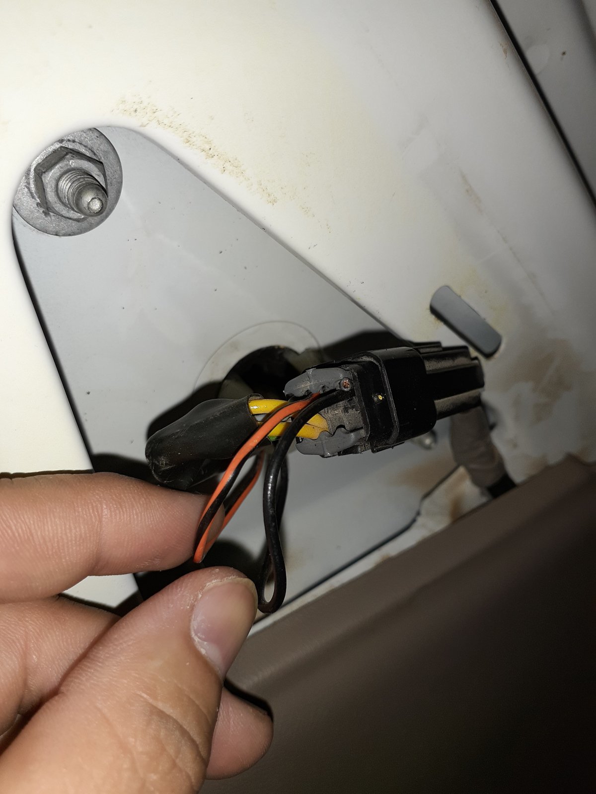

I depinned the 2 leads from lamp connector and pinned them to my old connector. Ground is already there on the door harness, all I need is to run the orange wire to the courtesy lamp supply and I'll have power
These are the 2 lamp leads to the connector.
This is the 2 connectors connected to each other. As you see on the door harness ground is there, all I need to do is run a lead from the door harness to door courtesy lamp power. And that should light up when hitting the key fob or interior lights.
Thanks for the help and advice.
My old mirrors have puddle lights but the new ones don't. I am going to install some small LED's in the bottom of the new mirrors for puddle lights and connect them to the existing wires in the harness. I will have to tap into the wiring harness under the dash for the turn signal lights to work. I think I got it figured out last night for the wiring. I just need the LED's to come in tomorrow, drill and install them and I'm good to install the new mirrors. I will take some pics as I get it done and installed. My old mirrors would not move anymore and one had the retaining ring and spring poped off so I had zip-tied it together. These new mirrors will be a long-overdue fix and improvement.
