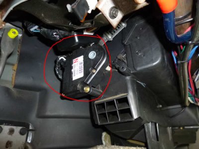

There is a motor down by the floor that controls the door. Mine used to go nuts and then just started working normal again. Didn't quite make the sounds in your video, but that's my best guess other than possibly the fan.

Thanks for the pic ill have to look into that. I started getting a little paranoid about the heater core, I hope not..
