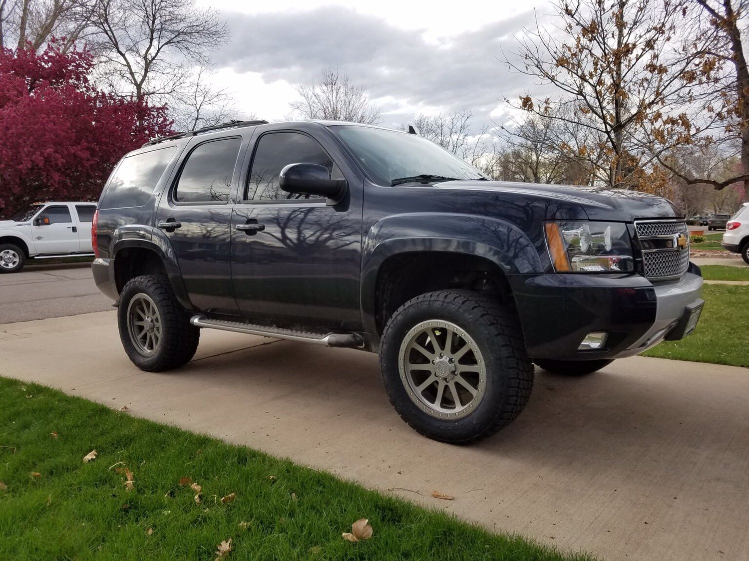

Buddy just did 3.5 inch rough country with 305/55/20's. Nice kit, drops the dif and comes with upper control arms to help with axle angle and alignment. Tough look without ripping the crotch out of your skivies every time you get in. There was some trimming. 33x12.5 should clear without much issue.
