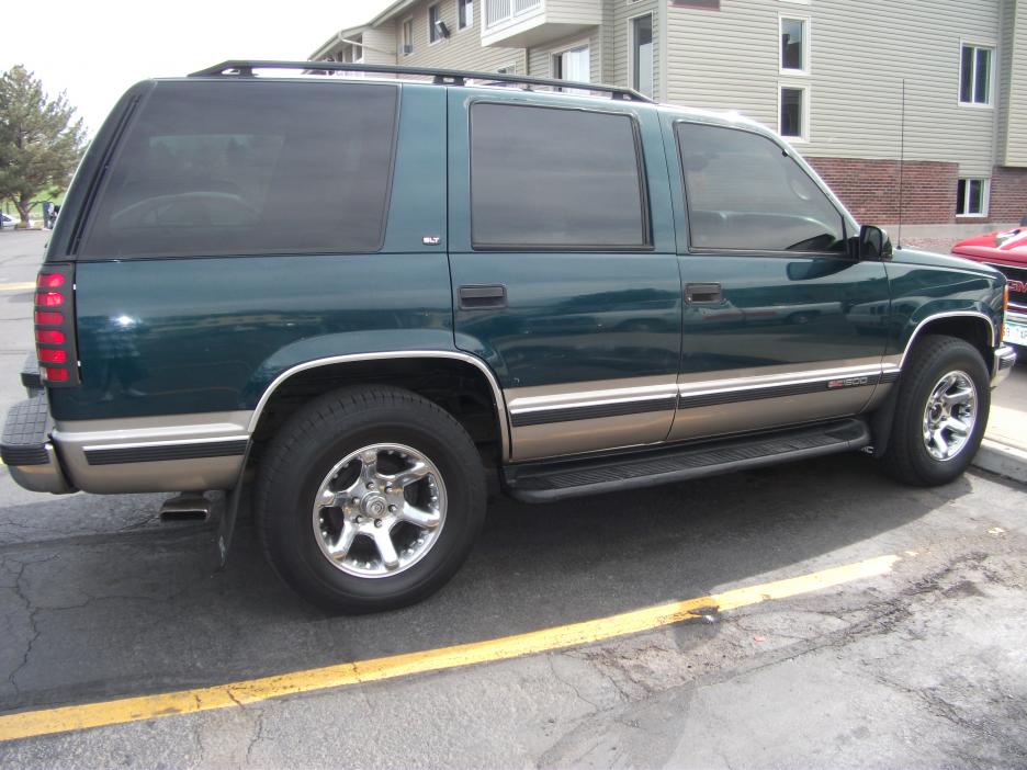

thanks I I have ordered the new plugs wires and cap/rotor since there's no telling when they've last been changed...your truck looks like mine except mine is green, same wheels and tail light covers, but i smoked mine out now though lol..

They do look similar. I believe your wheels are chrome though. Mine are some crazy bare aluminum finish.(came with the ducks unlimited conversion package) I like the chrome much more though.

Agreed, lately i've been wanting those fender flares u have but whenever i search for them all I get is the huge off-toad ones, any leads? I think they make the truck look 'classy' yet rugged. Yea my Kon came with the chrome wheels, they're 17s wrapped in 265/70/17
