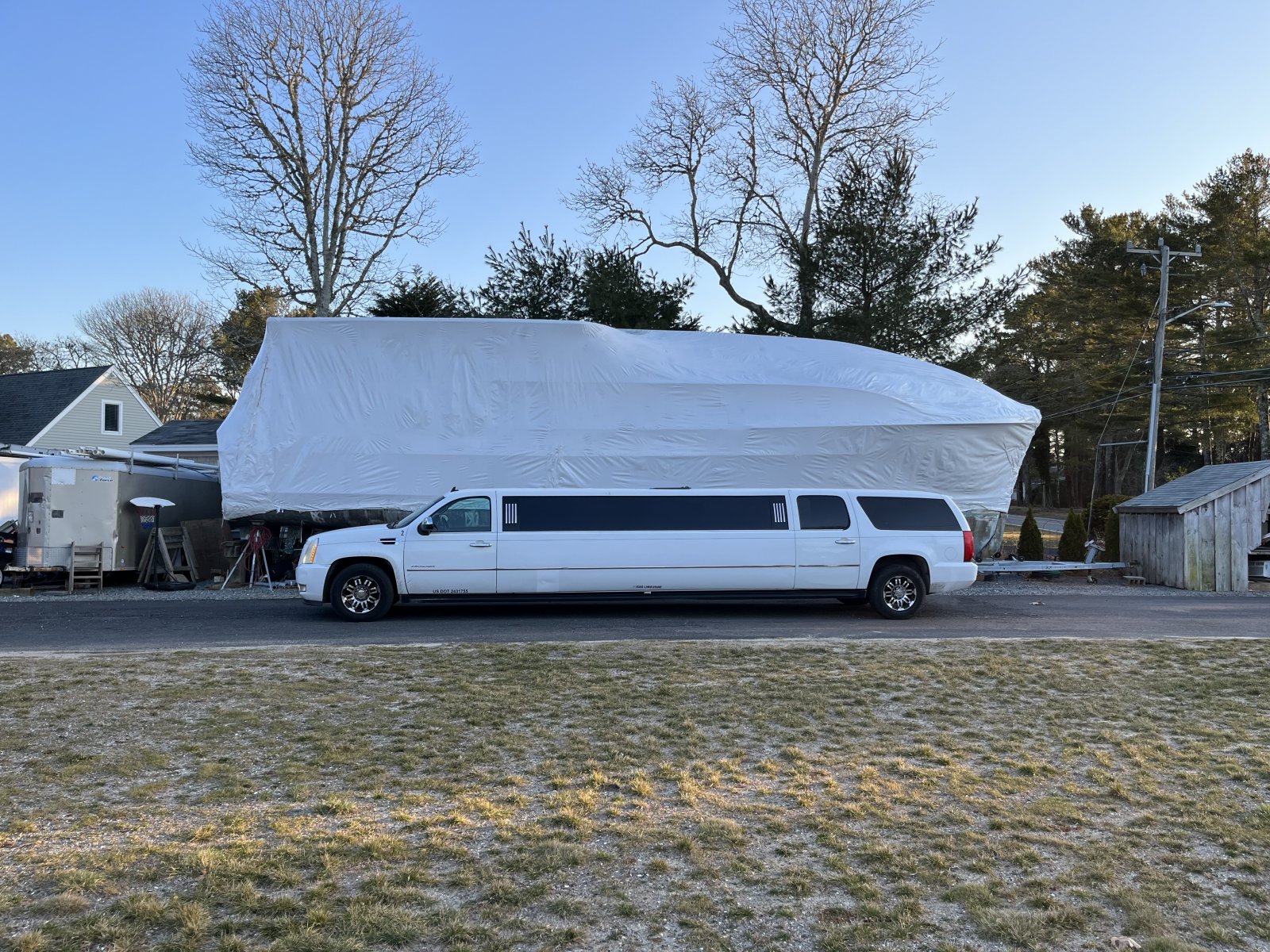

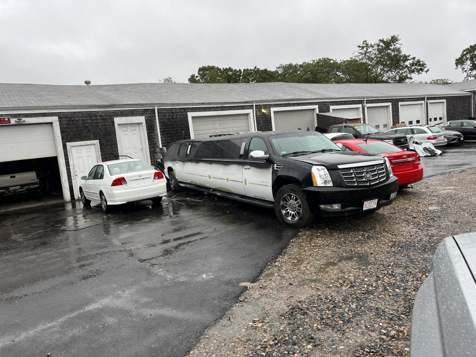

Thought that might be what you’re asking but she is in paint. Going two tone black and white. Had another doner Escalade with a blown 6.2, so I swapped the nose and rear. I’ve been under it. 100 % stock, except the stretch.
I would upgrade anything that makes sense.
The interior is in perfect condition, but it is what you would expect.
