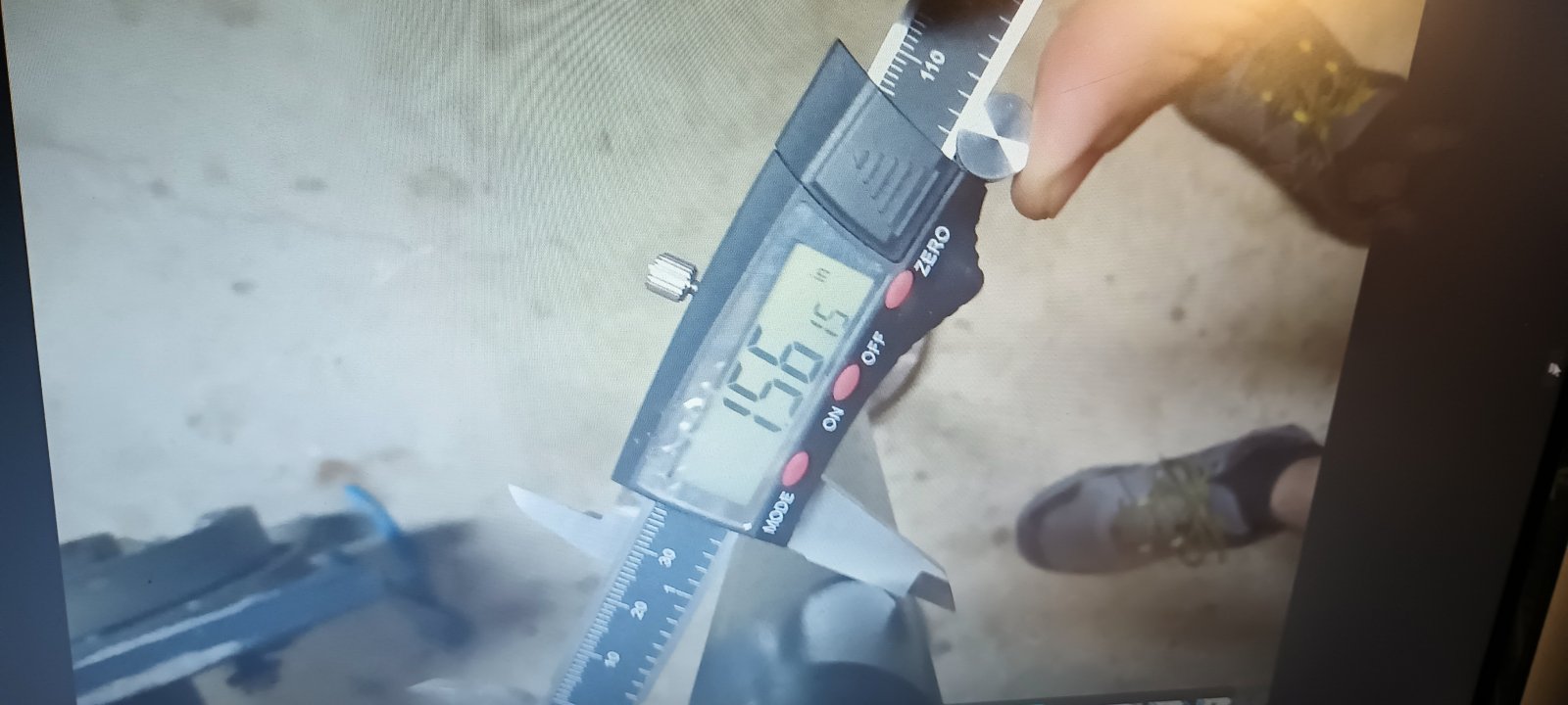

I regeared a 2014 axle 9.5 last year to swap into my 99 Silverado, but hasn't happened. I can't recall the spline count now.
These are like hybrid axles, the differential is based on the older 14 bolt 9.5", but axle bearings closer to the 10 bolt. I took photos of the axle shaft diameter. I'll see if I can find them later.

Here is axle shaft diameter. Again, this is a 9.5".
