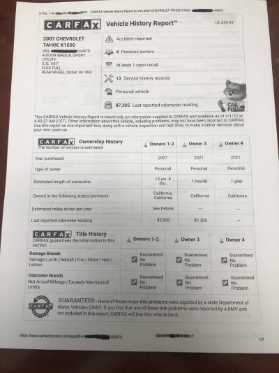

Here you go Caligirl

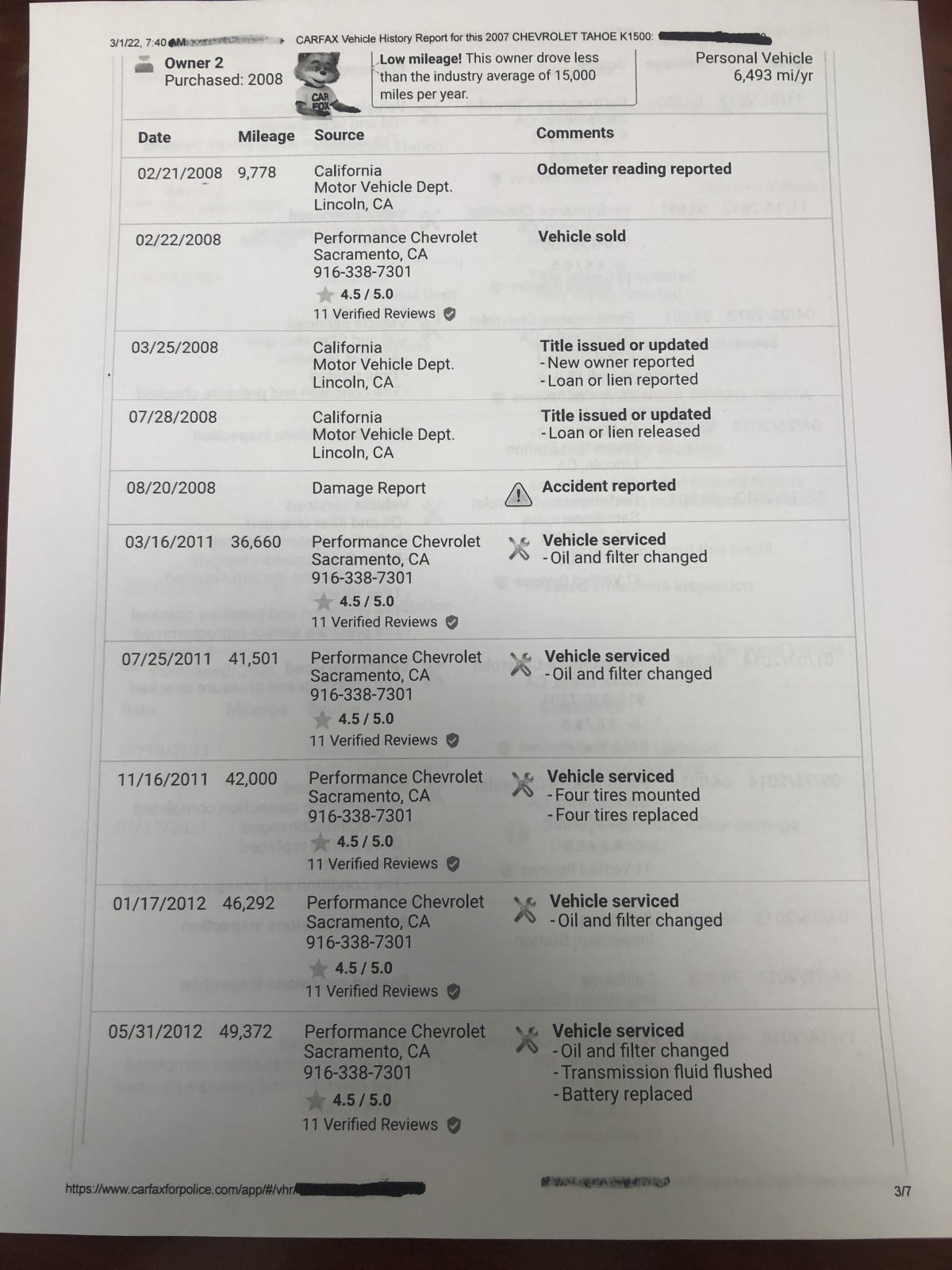

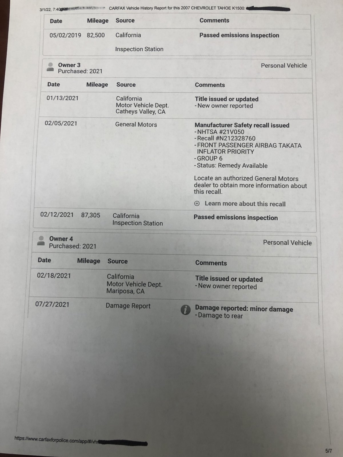

Woohoo, thanks! At least I can confirm regular maintenance thru 2014, but sadly no info shown about replacements/preventative fixes for those reported known issues. I suspect that during the 2014-2021 period before we bought it (only another 20000 miles) if pattern holds, probably started taking it to a dealership that didn't report. But definitely shows good history of maintenance. And daughter took it in at 86k for a 90k check up/maintenance at dealer and spent $1500 plus, including all new iridium plugs and wires etc. We now have 94k on it, so thinking this is a new problem. First accident was probably what caused the crease on bumper. That last accident listed was after we owned it for about 6 months and while it was parked in a parking lot, someone backed into it grrrrr. But the body shop fixed it right up and looks brand spanking new. At least we know oil kept clean, which sounds like for this engine is paramount to good engine health :)

Performance Chevrolet did a lot of work on that truck, that's who I'd call and ask for the service records. Often times descriptions like "checked computer" are code for major repairs.
