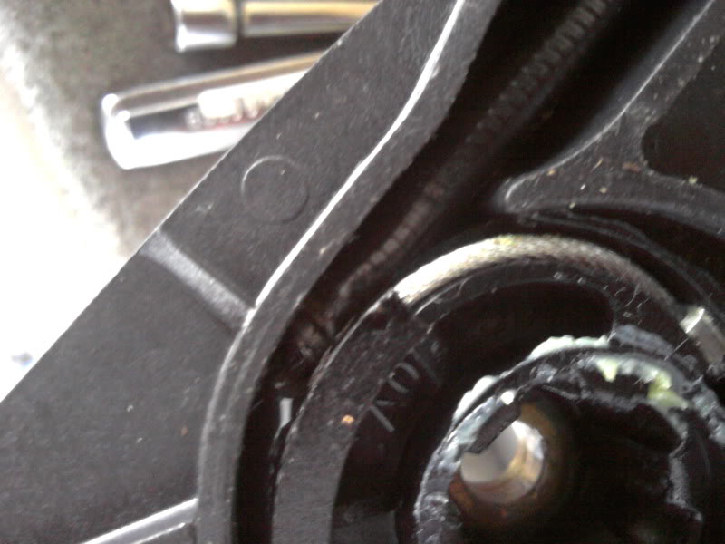

I know I promised some help in this thread but it's been a busy couple weeks. Anyway, I did want to share some pics that I took while replacing my regulator and motor assembly. In my situation, the cable and cover fed into the reel and would no longer back out. Here are some pics of what I found while it was disassembled.
