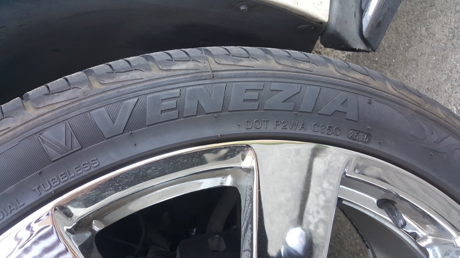

Also, what brand of tires are you running. That could be a reason for your ride quality or it could be a result of the parts that the previous owner used to lower it. :shrug: We won't know until we see pics, though.

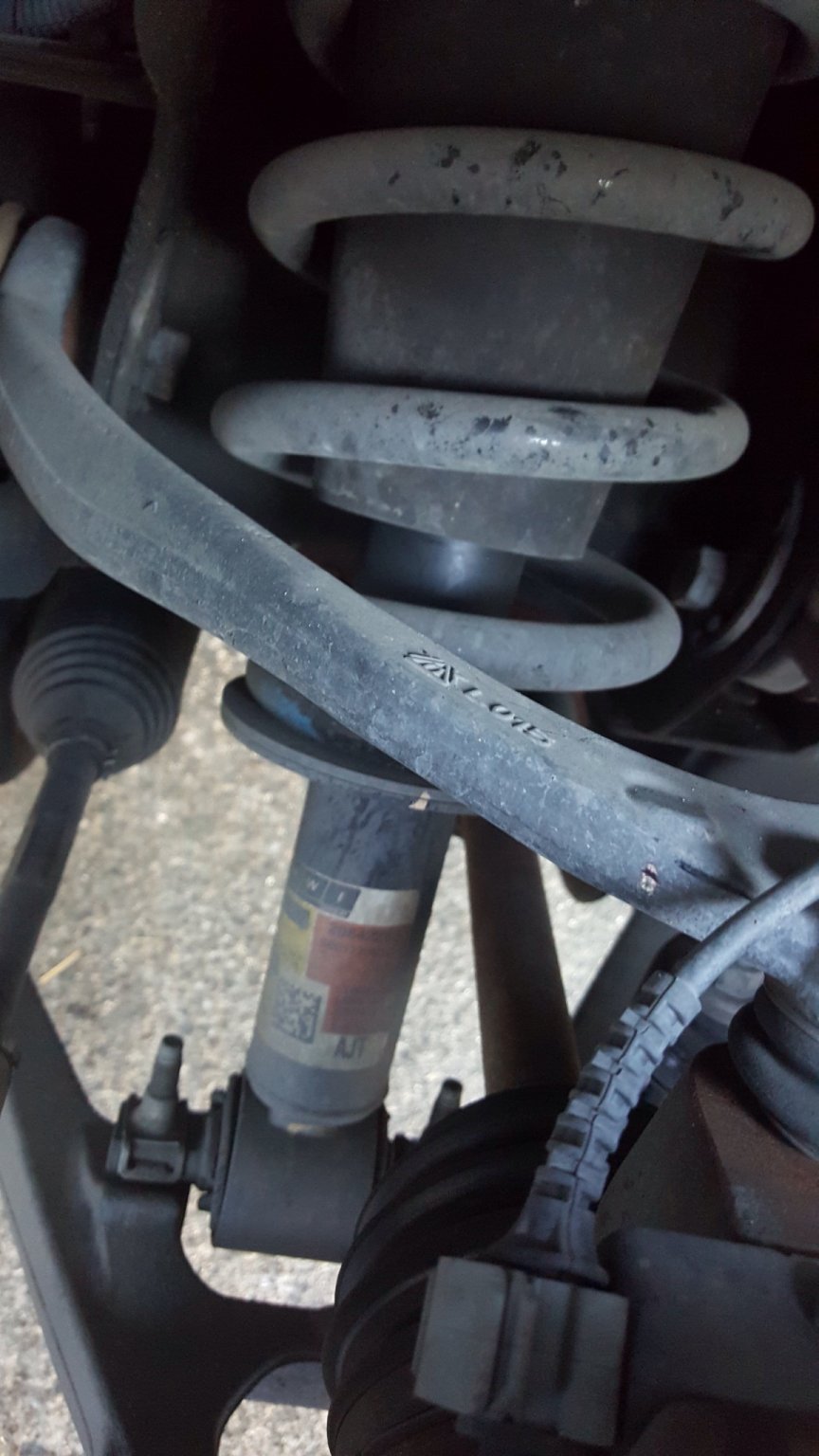

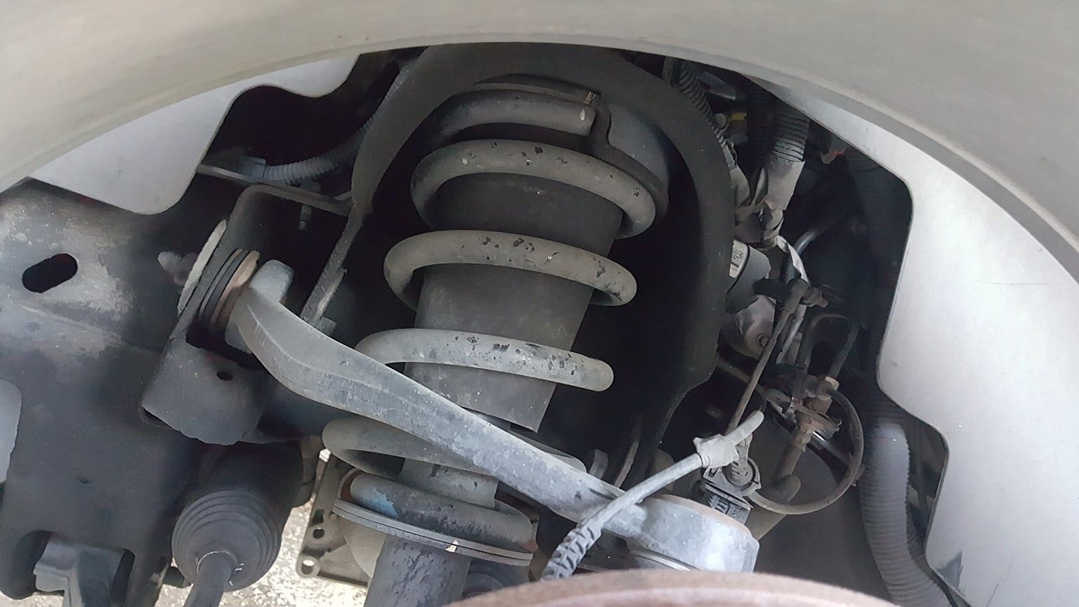

Front suspension;

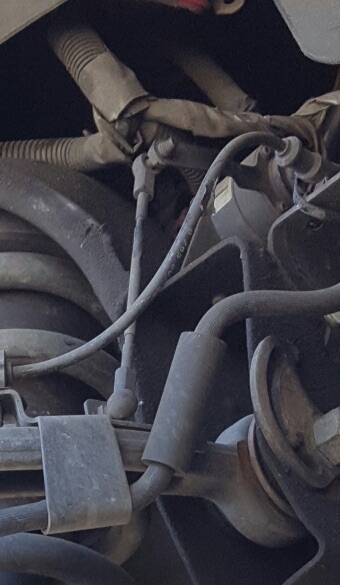

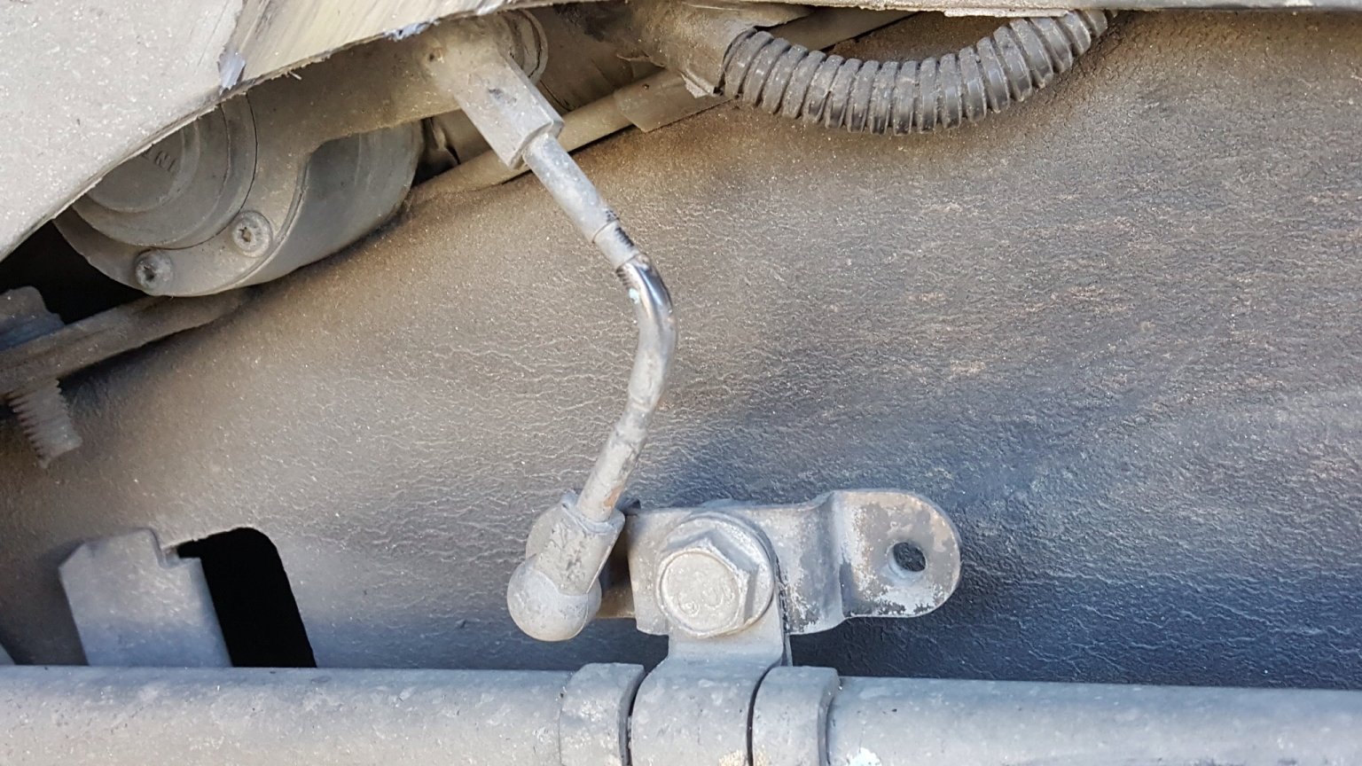

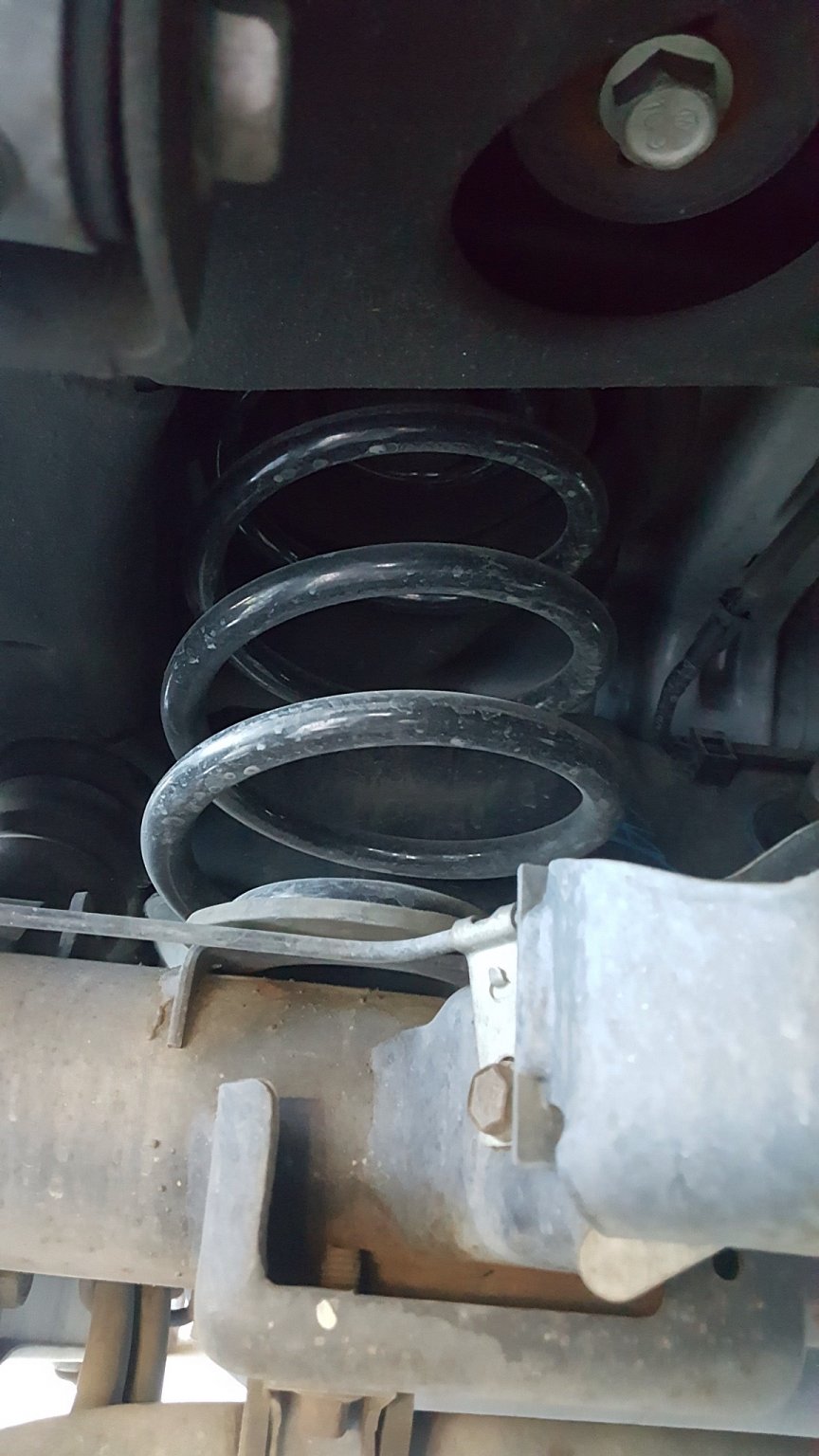

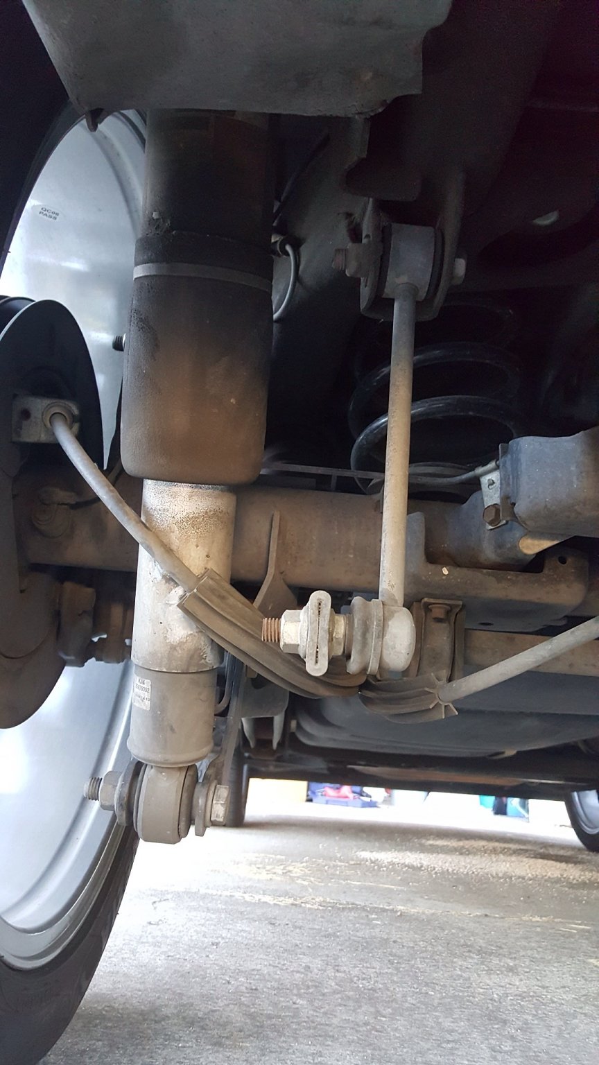

Rear suspension;

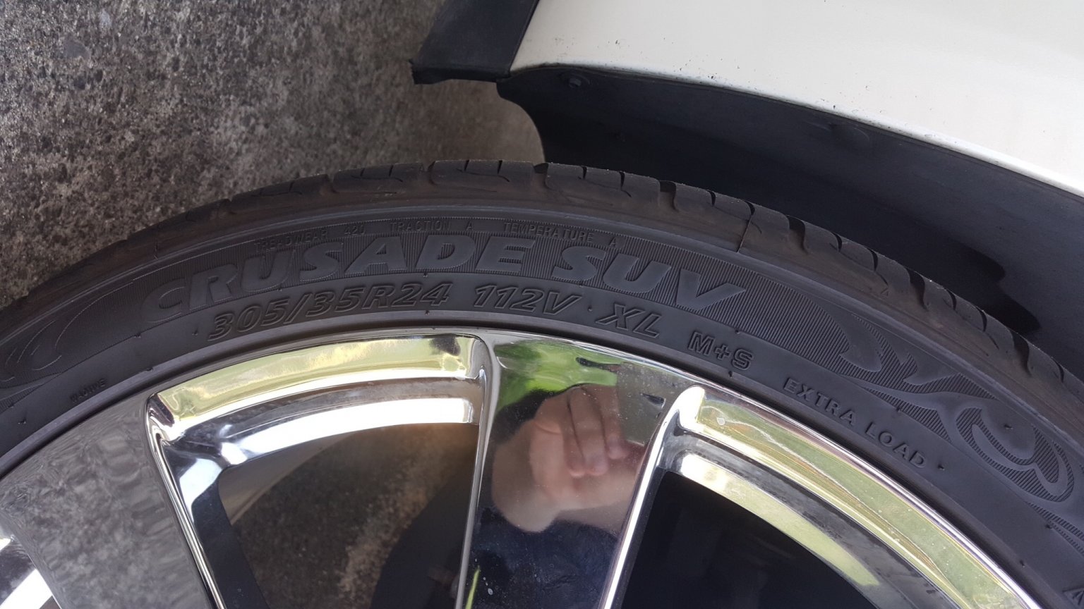

Tire brand;
The shocks looks OEM, but is it possible that the previous owner only replaced the springs?

People often retain factory Autoride when doing a mild drop on these, so it is very possible that your truck was lowered on OEM shocks. The rear springs appear to be a lot newer/shinier than the parts around them, don't they? That would suggest it's been lowered.

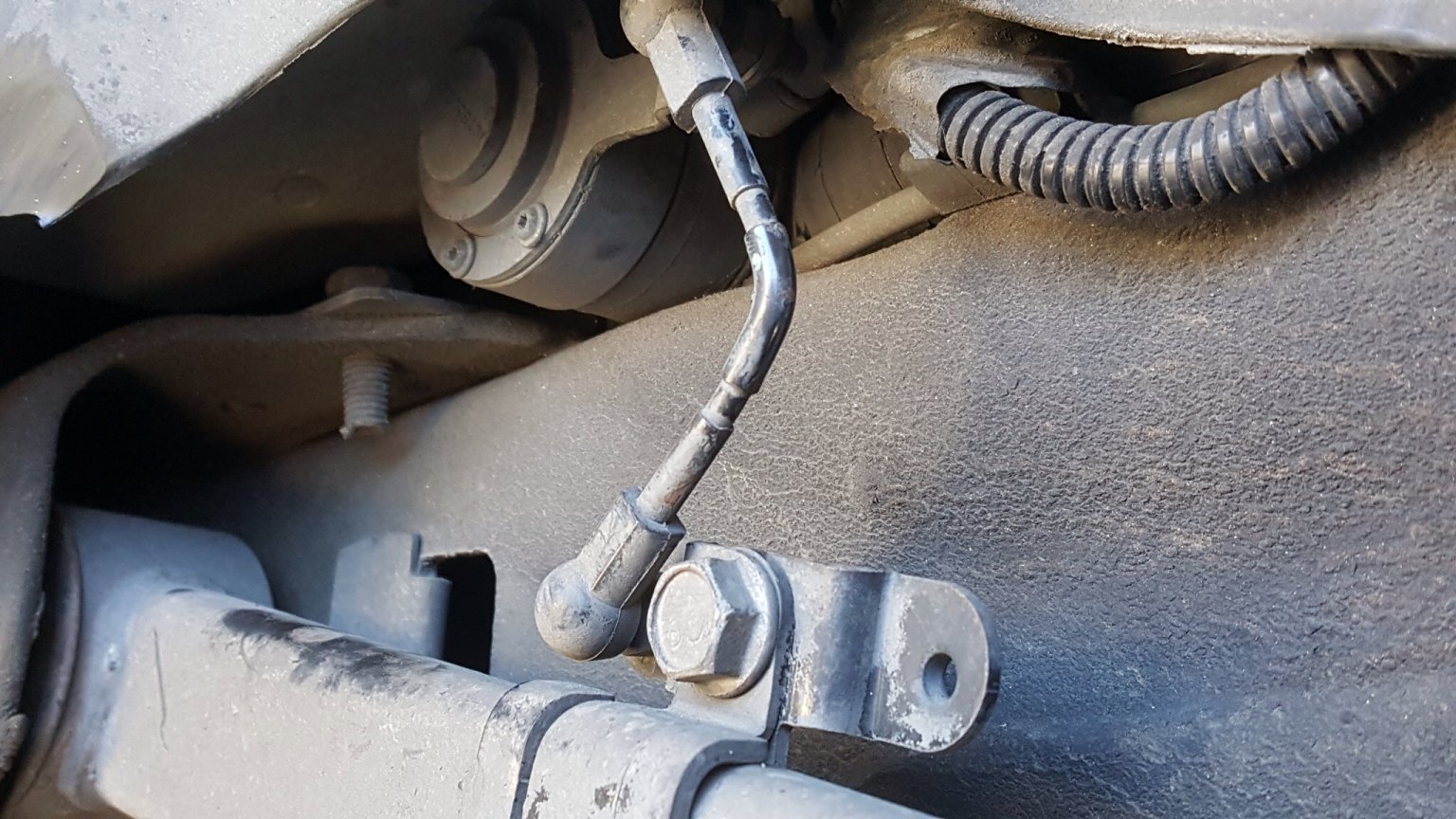

If you can, take a picture of your rear autoride sensor links. We should be able to tell fairly easily if they've been shortened.
The front could be spindles, look for a brand stamp on there somewhere or take a few pictures of the hub with your wheel off from different angles.
