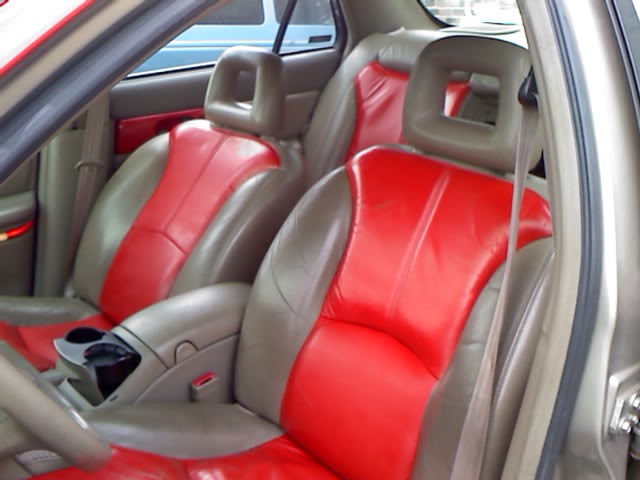

who thinks i whould be riged to paint the center of the seat and tape off the rest for a 2 tone?? im thinking about it
riviera rider
Oct 6, 2009
410
like this??? lol

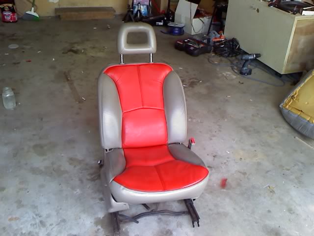

i learned the hard way however and had to do mine twice. i got that cheap ass duplicolor vinyl paint from advanced auto and that shit pealed off in a week, and was a pain in the ass to get off the seats to redo them.
definley use the SEM brand product
i used the sem cleaner, sem adhesion promotor, and sem vinyl spray cuz the color i wanted for the leather i would of had to order up different colors and mix it my self and spray it with my spray gun.
however its holding up pretty damn good been over 2 months since i did it and the drivers seat has a little wear but only where the original creases were b4 hand, besides that the color hasnt faded or pealed off
NOTE THIS PICS ARE FROM WHEN I DID IT THE FIRST TIME WITH THE ****** DUPLICOLOR AS U CAN SEE THE SEAT IS KIND OF GLOSSY, THE SEATS LOOK THE SAME NOW BUT ARENT SHINY AND LOOK LIKE THE ORIGINAL LEATHER JUST RED
