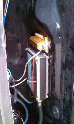

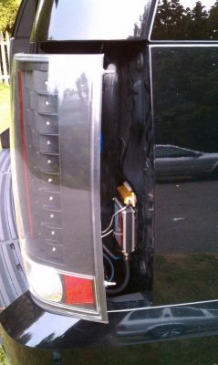

i used autoluminations kit with Phillips 6k h11 bulbs. Its fits in, but it not perfect. I siliconed the bulbs so there is no moisture gets in. I followed this link for the idea, But instead of using spade taps, I cut off the Reverse Bulb socket becuase i didnt want to have a open socked that energizes in reverse. Doing so left leaving me just the Power and ground bare wire. i then cut off one end of the harness opposite to the Side that plugs into the ballast. Stripped the ends of the wires. I then used a crimp connector that had a heat shrink tube built onto it. i then proceeded to use another Heat shrink sleeve that covered the Crimp connector to ensure no moisture get into the connector at all. Mounted the ballast and Load resistor behind the lens assembly, connectors facing down so no water can make it way into the Ballast connector and sit there risking premature failure.

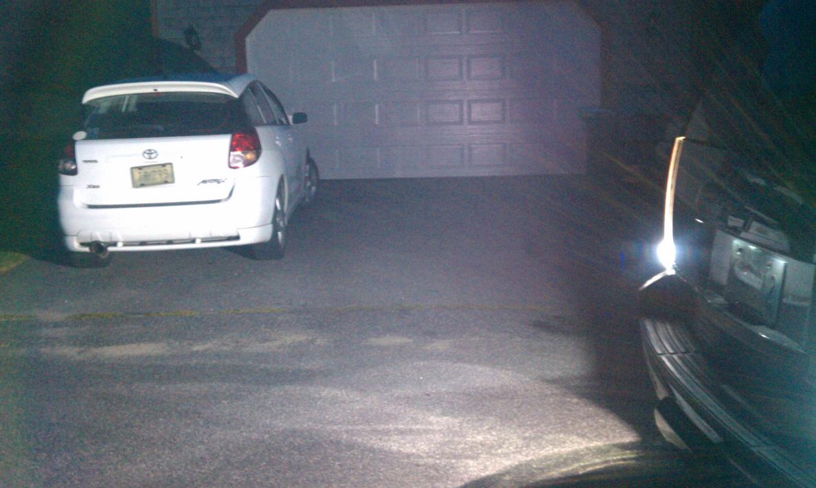

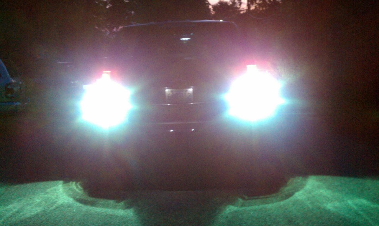

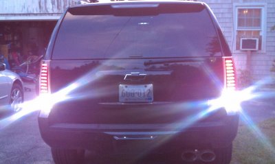

pics
