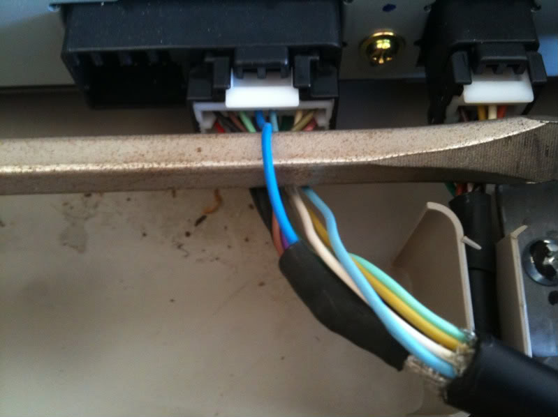

Cut a 10ft to 12ft rca at one end...
Take your tv/dvd down...
It will look like this...
Grab the blue wire and tap into it carefully...
That will be the positive or inside RCA wire. Then just take one of the small screws off the dvd player and run a wire to it via a round wire connector. That will be the ground.

sounds about right. but i would look into a video booster, running 3 monitors off a factory feed might not be the best idea. i just like to be extra careful with stuff sorry

Thank you. Exactly what I was looking for. Is the video booster necessary?

You can possibly get away with not using a booster, but the booster wouldn't hurt anything only improve the signal.
