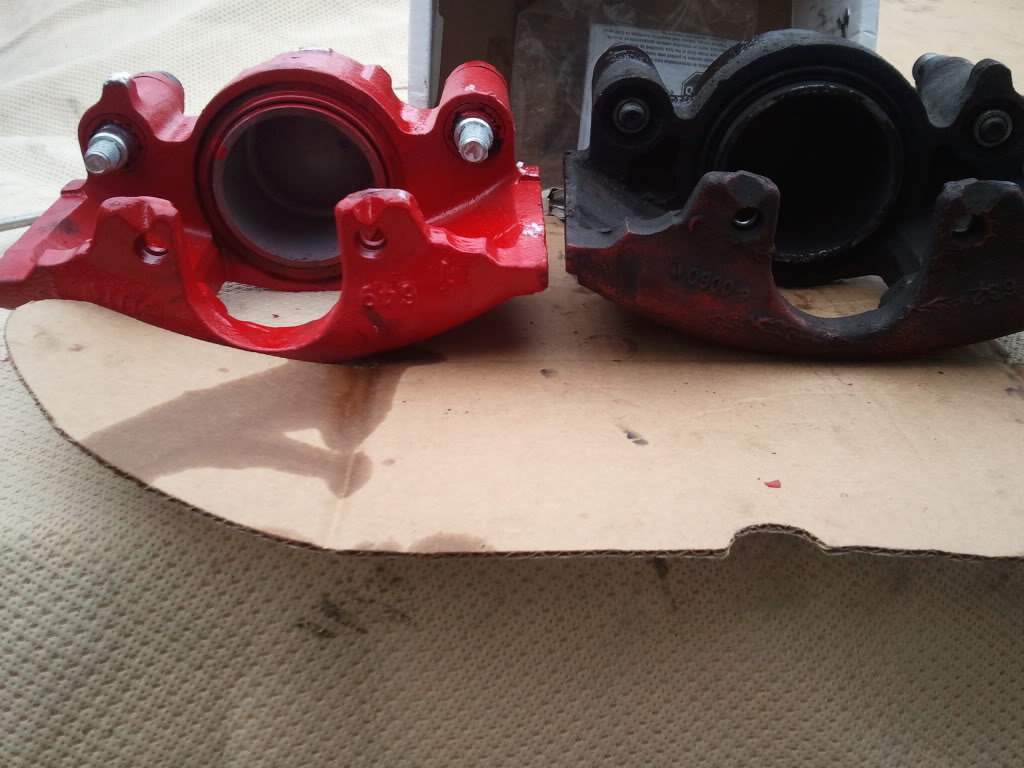

Amazon caliper 35000 express GVW 8600 caliper, I painted red
. And my stock caliper

Everything installed... As of 4/7 I've been using everything for 5 days now and very noticable difference... I am very happy with the install...
