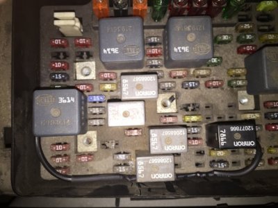

-First find the Headlamp relay on the left hand side of the Fuse Box. Remove it and insert the end WITHOUT the grey band into the top left plug (86).
-Second find the Fog light relay toward the bottom right as shown in the pic below. You will be connecting the end of the Diode with the Grey band into the top right slot (87).

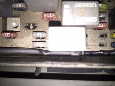

-You can now replace the replace the relays into their original spots making sure that the ends of your wires are securely touching both the fuse male ends as well as the inner metal of the sockets. You can then route the wire however best suits you.
That's pretty much all she wrote: This is maybe a 15min job if you know how to do it correctly. Don't ask me why they go into the particular plugs. I tried every possible way until this one finally worked after countless hours of fruitless googling.
Picture below of my fuse box. The big grey square fuse is the Headlamp Relay and the Rectangle Black Relay is the Fog lights. **Oops just noticed I put the Relay back in upside down, but it doesn't matter it's still plug 86 that you need to wire into.

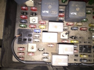

tried to do this a while back. Shouved the wire in there, and had a hell of a time getting the relay in there as well. Thought I had it and half way home my lights (headlights) started to flicker on and off. I took the wire out thinking it was causing my relay to not seat well enough. Few days later I tried it again and really made sure everything was connected well and same thing....bout halfway home the flicker. I pulled over and it was still flickering when the car was not moving and making a noise from the fuse box. I put the wire in the upper left prong in the grey relay, and the upper right prong on the black relay like what is circled here in red......
Anybody with input?

Yeah, don't use wire, use diodes to control the relays. Using plain wire is going to cause the relays to go haywire (just like you're describing). It will also stretch & bend the contacts, which will make the relay lose contact with the fuse box (which will also cause the issue you're mentioning).
If you need more detailed help, I'd be happy to assist. Just let me know what you're trying to do exactly.

chef choy, I'm just guessing here, but... Based on his comment
I'm guessing you've connected to the wrong post of the relay. The bottom of the relay should be marked as he indicated, one of the posts should be 86. Double check that, and not the orientation of the relay as plugged in.
