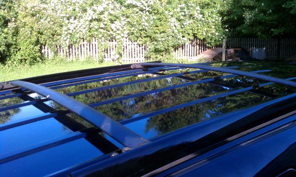

Ive finally got them painted and installed. Had them color matched and Cleared.
picture.php
Sanded and ready for paint
picture.php
picture.php
Freshly painted
picture.php
picture.php
Fully assembled.

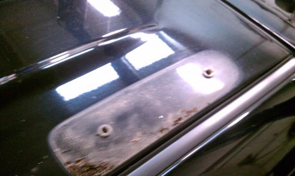

there are 5 bolts per side. 2 on the front end, 2 on the rear and one in the middle. They are a T25 torx Bit. Once unbolted, the whole Rail is Ready to come off. Save all the bolts, your going to reuse them. Repeat for other side.
picture.php
Now is a good time to Clean the area under the old roof rack. I ended up washing and Buffing those areas. Some of the outlines can still be seen but its on top and im not to worried about it.

Install all the end caps and relax. Your done.
