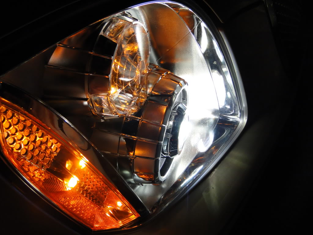

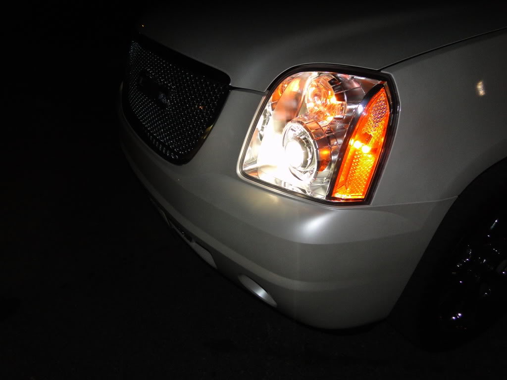

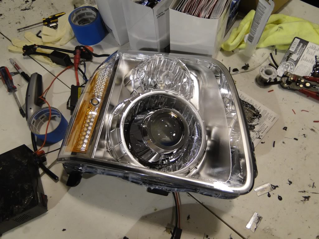

Headlight Retrofit:
Hardware (also including cost because people always ask me):
Projectors: RX-350 Bi-Xenon ($225)
Lenses: RX-350 oem lenses custom polished clear ($50)
Bulbs: Osram Xenarc SVS D2S 4200K ($200)
Ballasts: Morimoto 5Five (50W) ($110)
Shrouds: Type K ($50)
Harness: Custom/Dedicated and modified for daytime 'flash to pass' ($35)
Park/Turn signal: Osram Diadem 3457 ($20)
Side marker: Osram Diadem 194 ($10)
DRL disable (pulled fuse)
Housings: TYC oem replicas ($200)
Total hardware cost: $900 + labor $.
Installed/Executed by Bjorn at customlightz.
