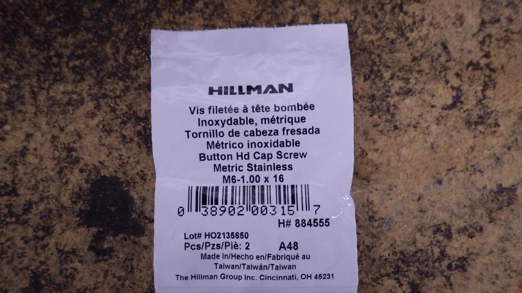

I just did it, get 10 of these from Lowes:

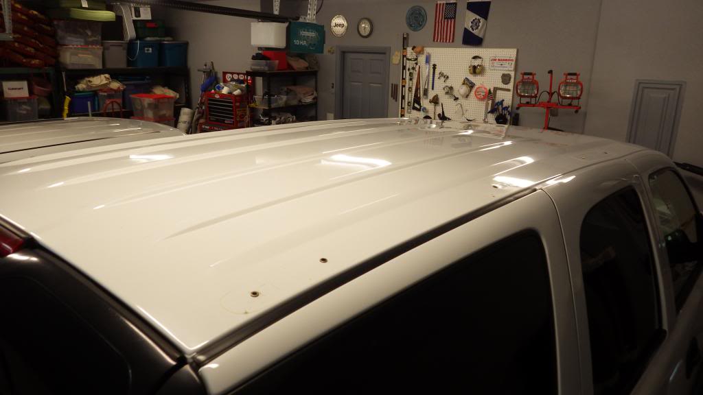

I cleaned the holes with alcohol wipes and put a dab of silicone on the screws before tightening in.
Done:

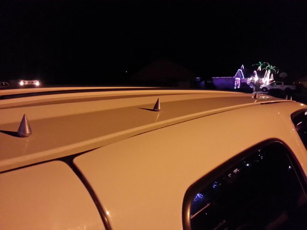

Always go the spiked route :hmm: Have had mine for few years, they screw in and sealed, but still able to remove if ever wanted. I also may want to use my rack again and didn't want them permanent. Haven't had issues with water or anything.
But you can see others have used many different things. Screws/bolts, button head, allen head, flush ect. Plastic caps and supposedly make a specific cap used for PPV vehicles. Could do a rubber strip or seal to cover over all holes. Just depends on how you want to cover them up.

Where did you get the spikes at?

I made them. I didn't actually make the spikes themselves. I got them locally, but they also sell them online. Just had to drill and tap for correct size bolts. Made a set for someone else few yrs back when I made mine, idk who tho.. Mike (tahoewhat) is making some similar, supposedly!! Giving hard time Mike.
Just wanted something different.

Lol. all good man. But yes, i have been messing with the idea of putting spikes up there. Its different and unique. Mine will be tad different than Whiteouts though.
But alot has been stated as most do to cover the holes up. I myself put inset screws in, they mount flush and then put some sealant on top and have no issues w/ water at all. But you can see where the bolts go. But, im pretty low though.
