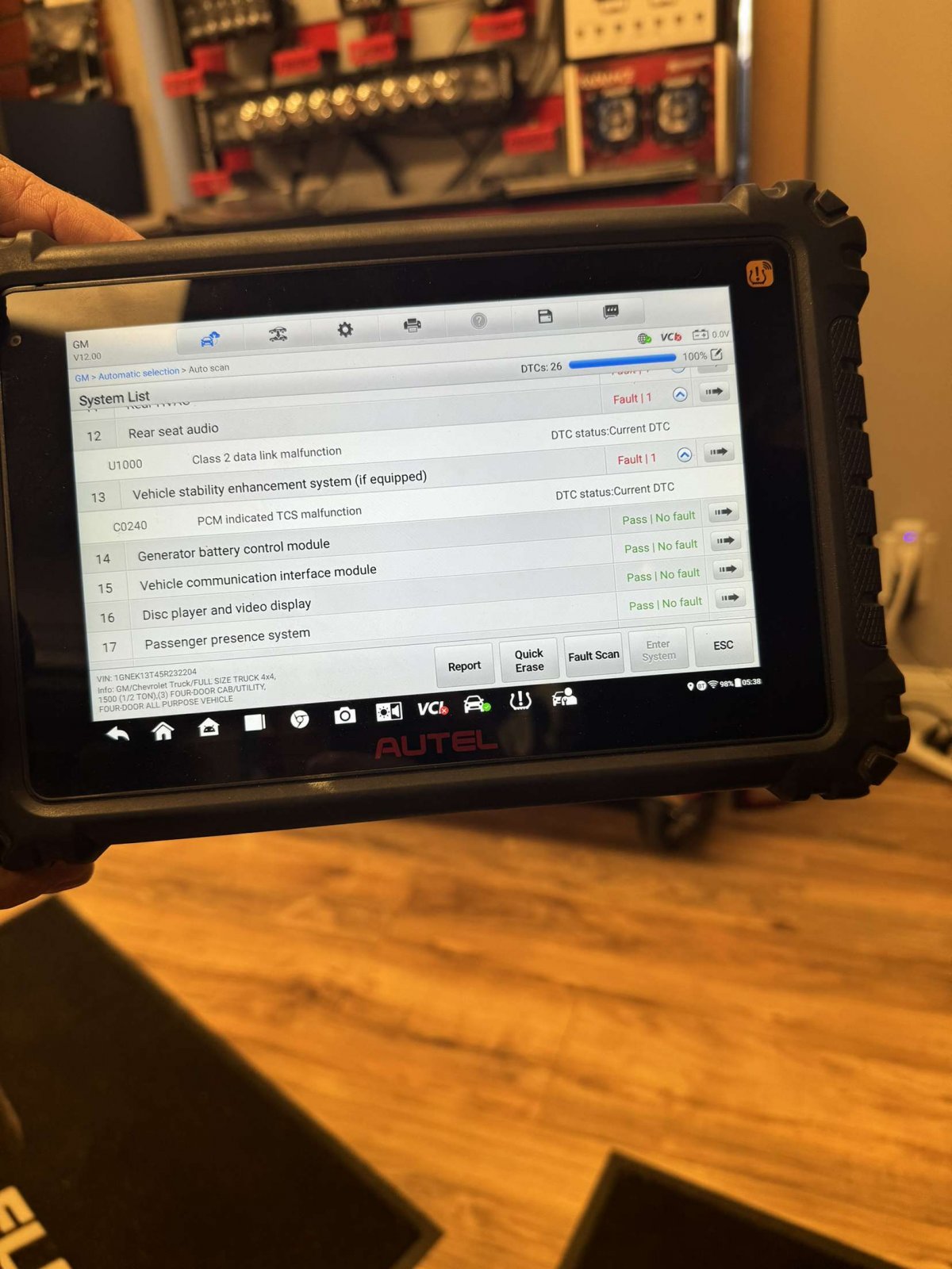

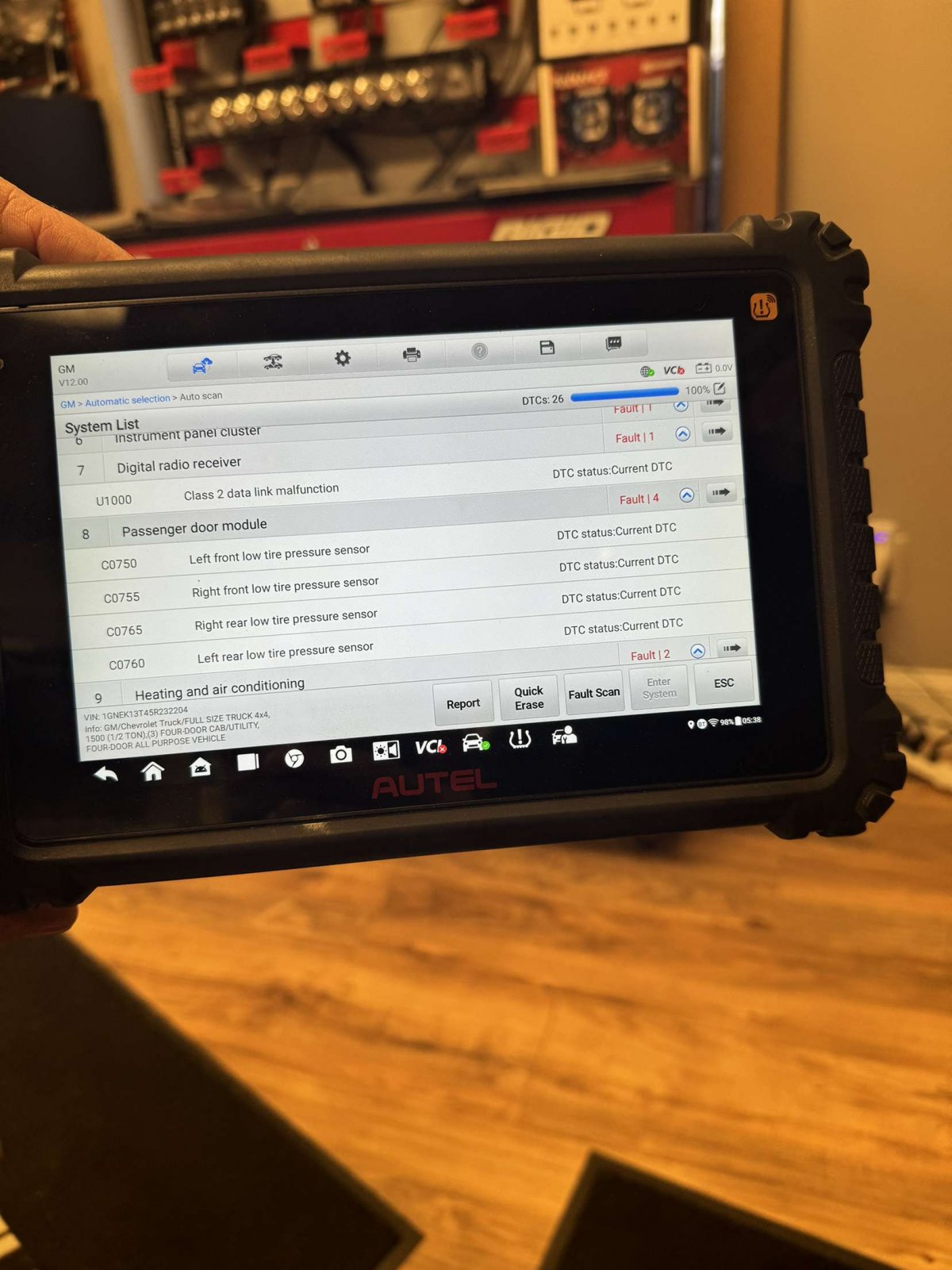

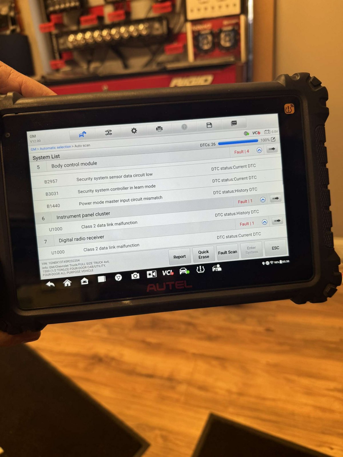

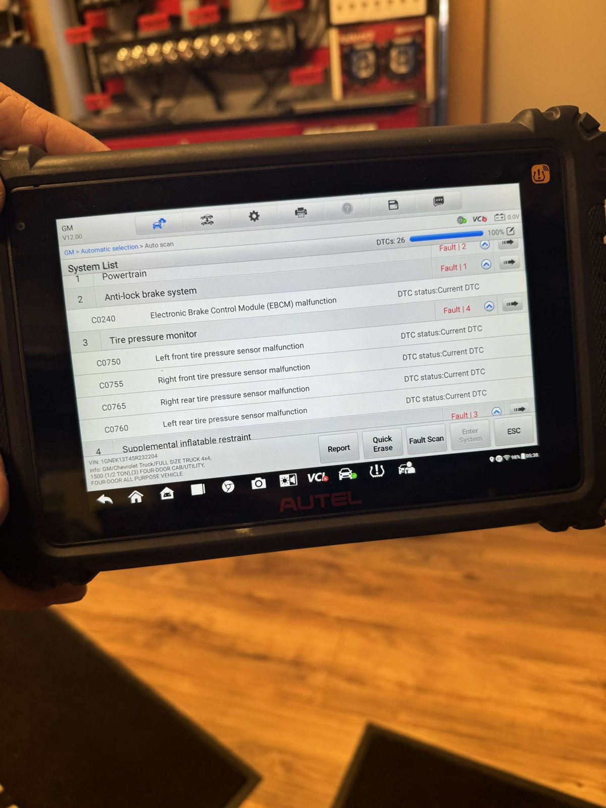

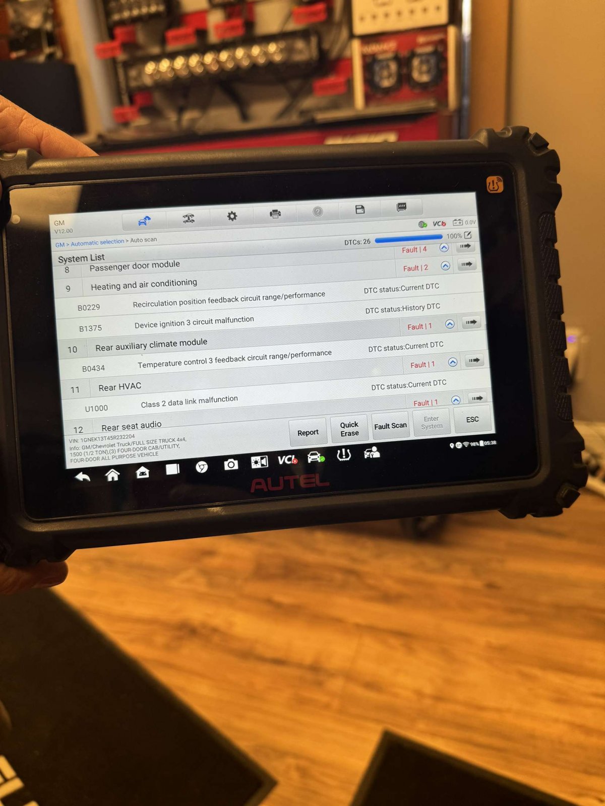

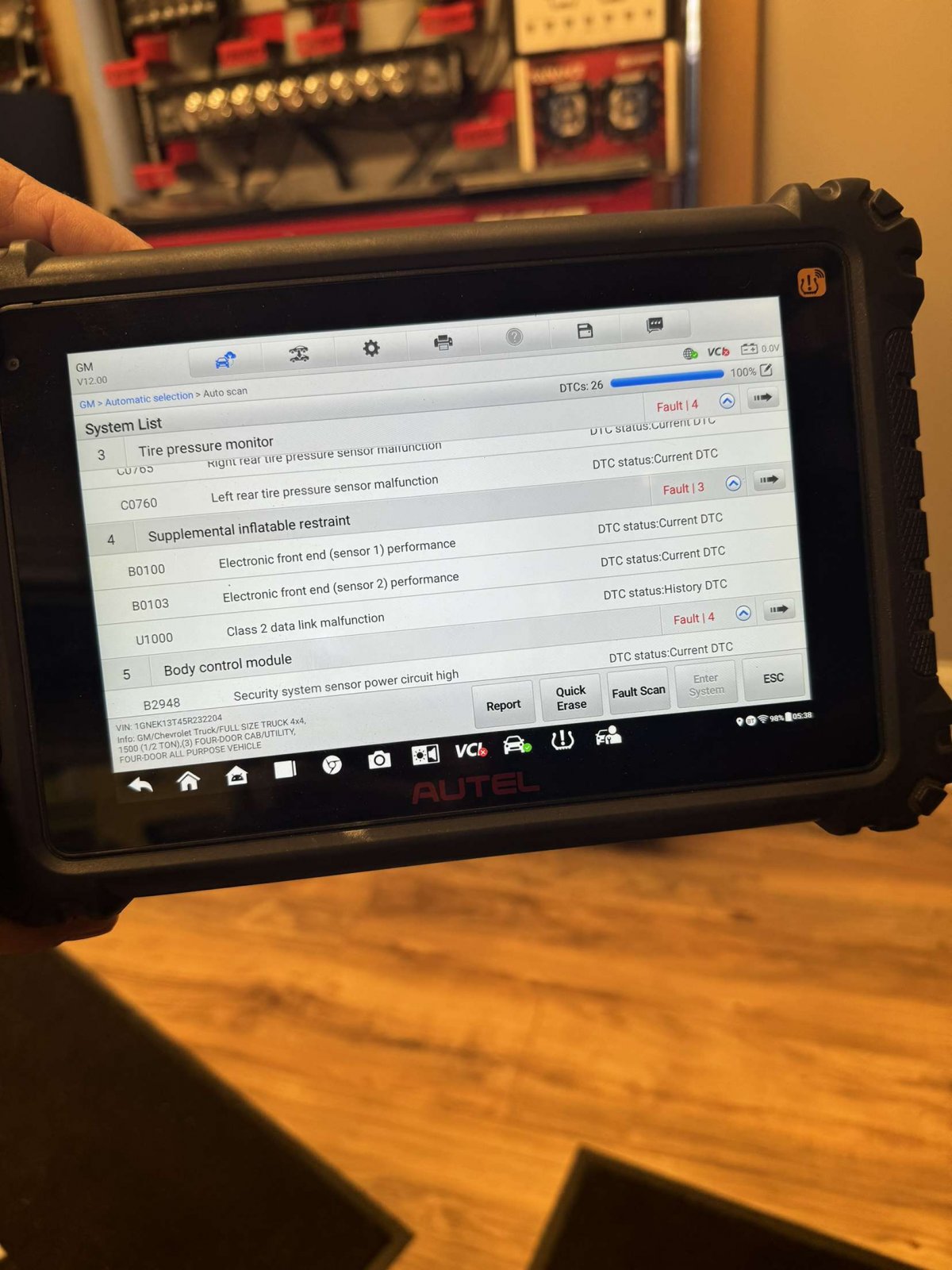

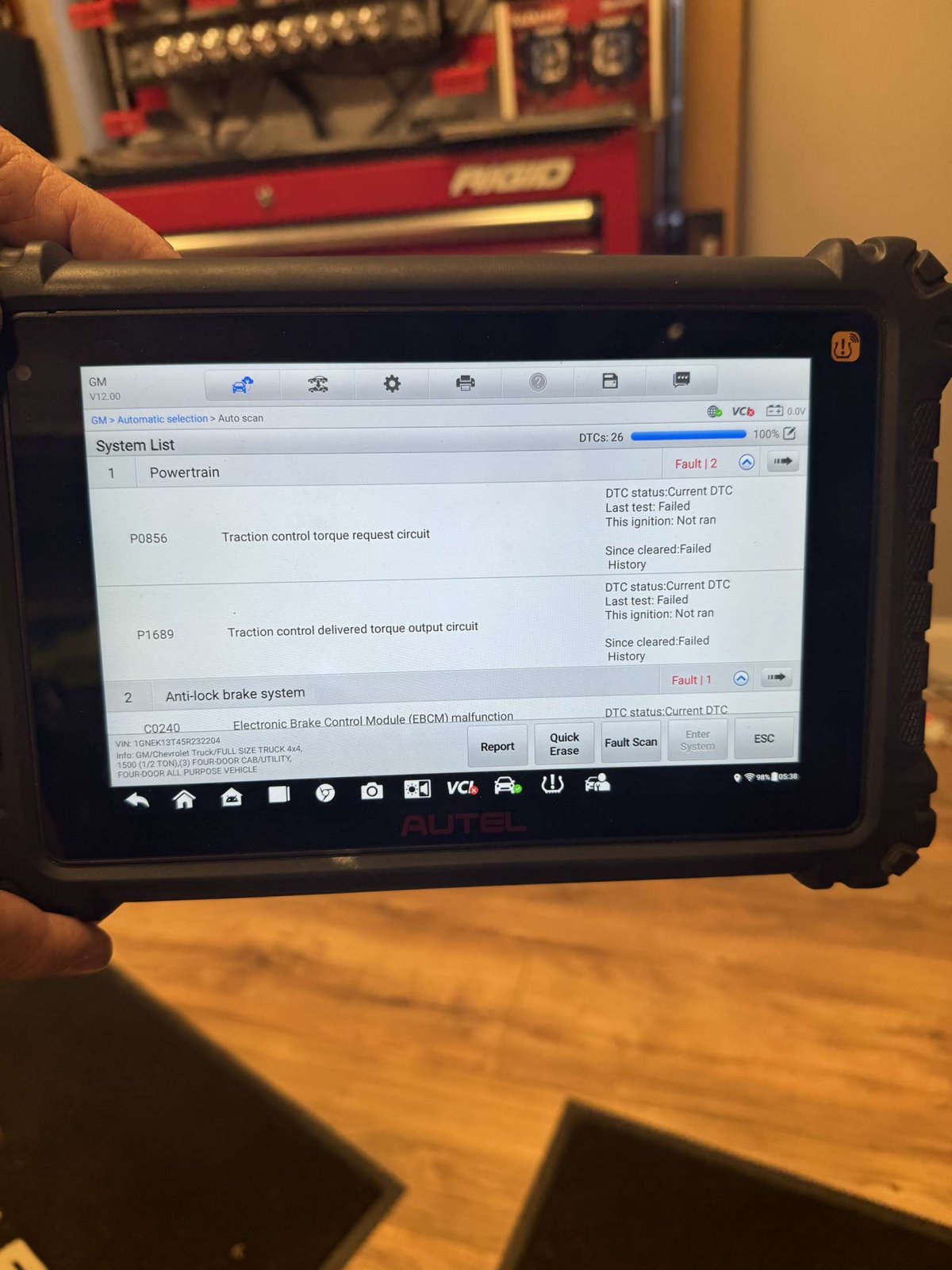

Sup guys, back again with my roommates late fathers truck we have been fixing.
ABS light and Parking Brake lights were on, and shuddering the passenger brake caliper coming to a stop.
( Whole suspension, front and back, rotors and pads, suspension and shocks, tires and everything are all brand new. Calipers seem to function fine so they didn't get replaced. Brake fluid is dark and will be flushed eventually once I find out how to do it properly given the ABS system, brakes work but are soft so I assume the trash fluid is the issue. Reservoir is full, no leaks )
Pulled the ABS fuse in the interior fuse box temporarily, installed new Hubs with Abs fuses and a quick test driving backwards after the ABS functioned fine. Drove for two days and no more lights.
Now however the ABS, Parking Brake, and now Traction Control light comes on. Testing again driving backwards shows ABS doesn't function.
This issue however comes and goes.
When the three lights are on, the T/C button doesn't turn the light off. However after cycling the keys on and off the lights will disappear. Then I can manually turn traction control on and off.
Just looking for a suggestions, apparently it can be the ABS module, or Air pump? Maybe electrical or ground issues, but if anyone has delt with this issue before please I'm all ears.
Traction Control light didn't come on before the new hubs.
Thanks!
