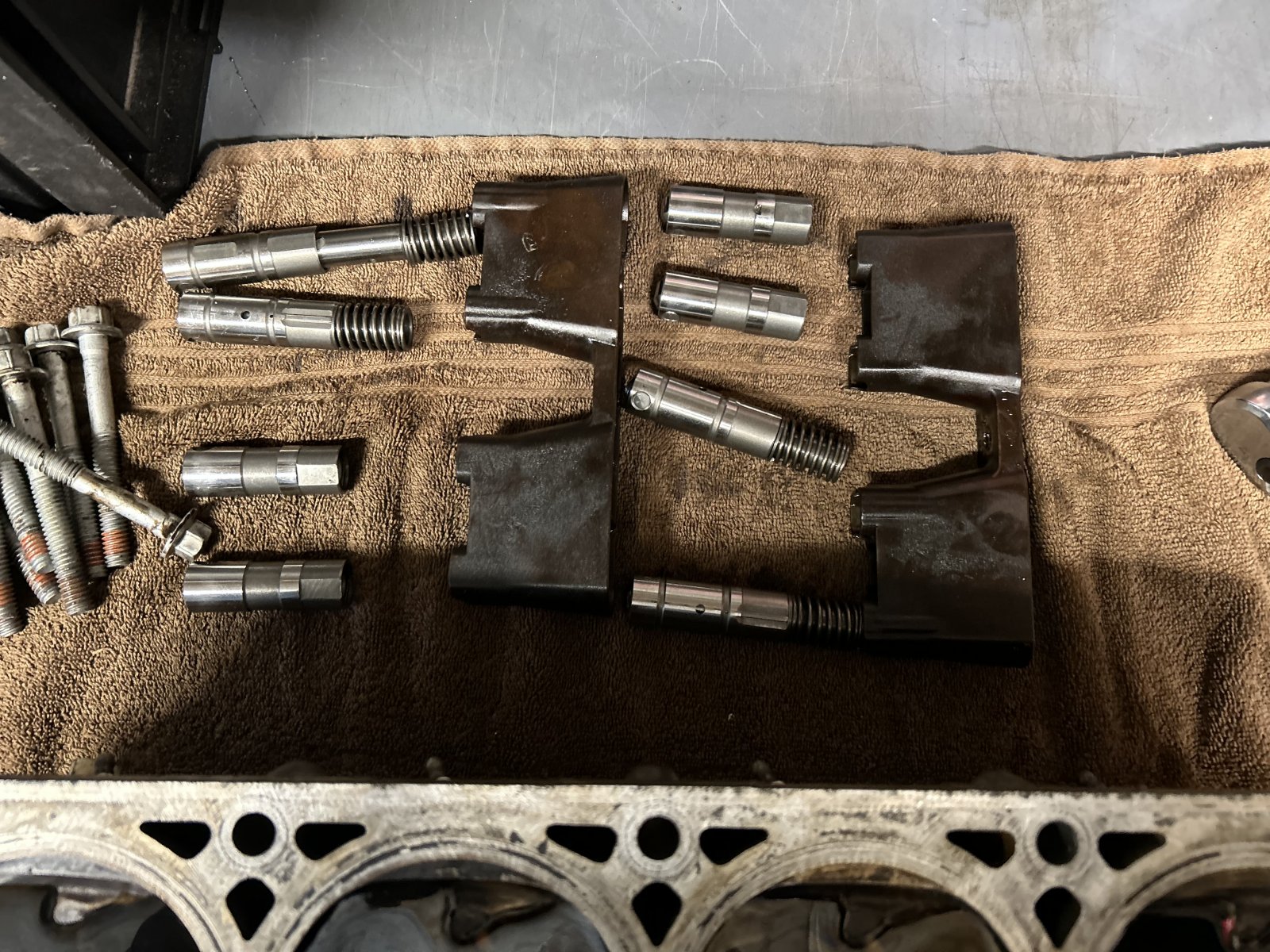

Well had to dig in since I was pretty bored and all honey do list have been completed.
Pulled the head and low and behold. May slap together with known good lifters. I have the original ones from bank one that were not an issue prior to rebuilding. Worst case I make till spring fingers crossed and this will buy me time to find a replacement motor and have it deleted.

Last and happy update. On this thread and a learning curb.
After rebuilding bank 1 lifters with OEM still had the misfire on bank 1 all cylinders and FT were crazy -16–20%
Went ahead and rebuilt bank 2 with OEM lifters and while at it replaced the oil pump with Melling 365 and green O ring. 1st start after completed was amazing. No ticks OP just over 60psi once at operating temp idle OP is just below 40psi I’ll take it. Rig is super quiet now and all misfires FTs are normal. I’m so glad I finally got this figured out.
Also the power is awesome. Now I’m gonna look at getting one of those DOD disablers in hopes for saving the lifters from collapsing in the future.
Lesson learned use only OEM parts and never try the cheap route.
