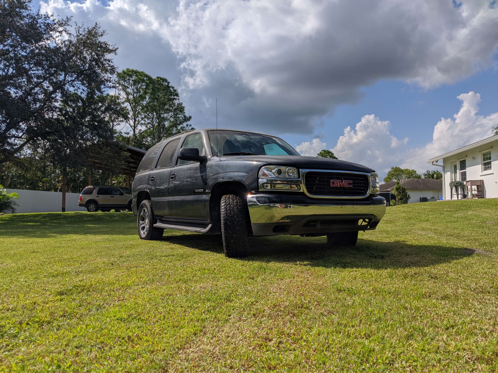

How much horsepower will i get with a tune, Headers and catback?, And how much will it take for 400hp without a cam?. 145k Miles
You'd have to supercharge the truck to get to 400 horses. A tune is worth about 30-40 horses and is your biggest bang for the buck and the basis upon which all other mods build upon. The long tube headers add about 20 horses and the exhaust, not much if anything. Are those Florida skies?

Yes south East FL

Welcome to the Forum from NH.
Pics of the truck, please.

By the way... Nice looking Yukon and welcome from MA!

I wouldn’t say it looks nice lol, It needs some cosmetic work aka paintjob.
