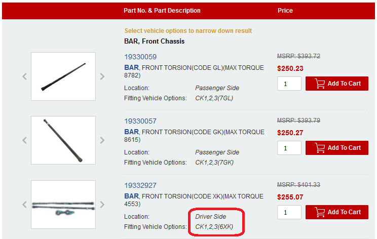

You'll probably need to find a Z71 RPO code label from one that is around your year, and check the "6xx" and "7xx" codes for the bars.
For example, my '04 with Premium Smooth Ride has these two codes: 6XK and 7XK. Looking on a GM parts web site like this: https://www.gmpartsgiant.com/parts-...ont_suspension_steering/suspension_front.html shows the same ones listed for both 2wd (C) and 4wd (K) using that RPO code.
Here's a snip from that site, showing the first three listed. I've circled the match for one side of mine, and you could do the same for the Z71 codes if you can get someone to post them:
Thanks for replying and educating me about the 6xx and 7xx codes.

I found a VIN number for 2002 Z71 Chevy Tahoe and a 2005 Z71 Chevy Tahoe. According to the GM Parts giant site, the torsion bar part numbers are the same for both.
Left side - 19332929 (code 6XL)
Right side - 19332930 (code 7XL)
Unfortunately, neither are available. Anyone know a source for quality aftermarket equivalents?
I was also able to determine the Z71 and non-Z71 Tahoes use the same green keys (15592573).
