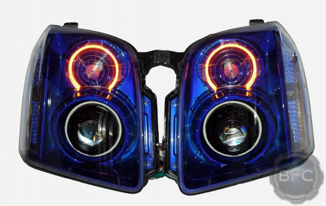

Customer Build Updates
–Customer: Shawn P
–Vehicle: 2007 GMC Yukon Denali
–Projectors: MH1
–Lens Upgrades: None/OEM Clear
–Shrouds: Apollo 3.0 In black
–Bulbs: Morimoto
–Ballasts: Morimoto
–Paint Theme: Custom Candy Blue & Black
–Vinyl Logo/Decals: BFC Logos in Black

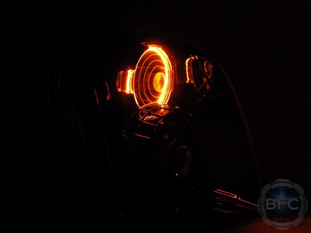

-Extras: QUAD XB LED Halos in Top & Bottom Slots
–Special Notes/Our Thoughts: Shawn wasn’t messing around in the looks department! We started with a set of OEM replica housings and sent his headlight pieces out to his painter. The custom candy blue seen here is also coated on the whole truck! Once those arrived back we fabricated the quad XB halos in, added the MH1 projectors and blacked out a set of Apollo 3.0 shrouds. The results are a drastic improvement in light output and a major custom aesthetic change – sure to turn some heads! Awesome!

Wow, rig looks good! I still don't understand why people go for the H1s. They have the weakest beam of all the projectors choices. The MD2S 3.0 would have been a much better choice for only $20 more.

It does look good :)
It's a super clean truck. The Mini D2S 2.0's actually have a weaker output. The MH1's pack a decent punch to be honest - they are the latest 6.0 version as well - which was a major improvement over past versions. These are what was opted for when the build was originally planned and they are a drastic improvement vs the stock halogens :)
