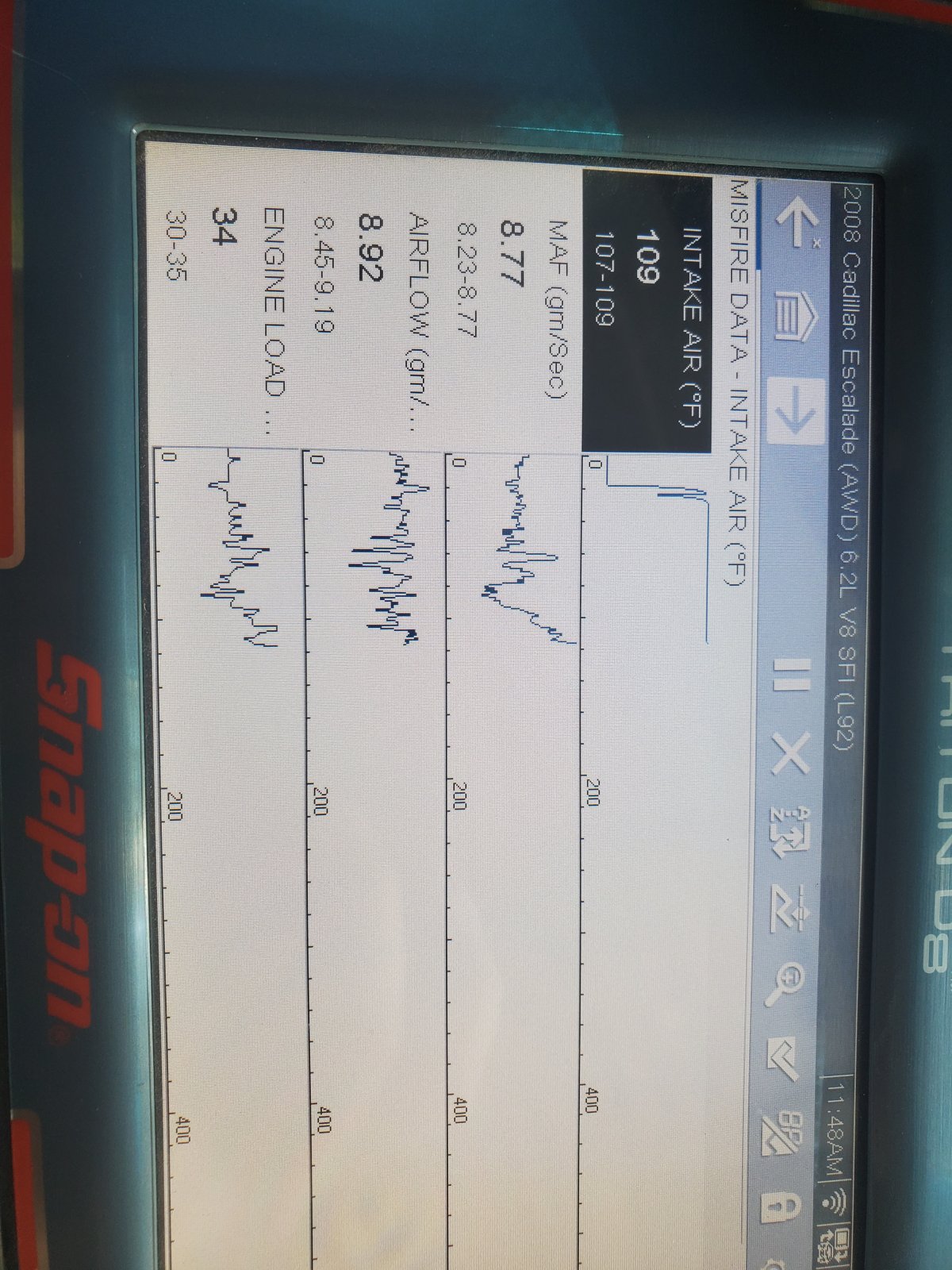

I am no expert but just spit balling
I would check the maf readings and ensure the temp readings are correct also if not already done.

What do the plugs look like? Running without the Y-pipe, as in no O2 sensors or cats? I’m guessing it stayed in open loop without any fueling control.
Look at the plugs and it’ll tell you if the O2 sensors are correct for pulling fuel. If they don’t look fat rich, it may be your O2 sensors.
This is a hard to say for sure without looking at the parameters while running.
