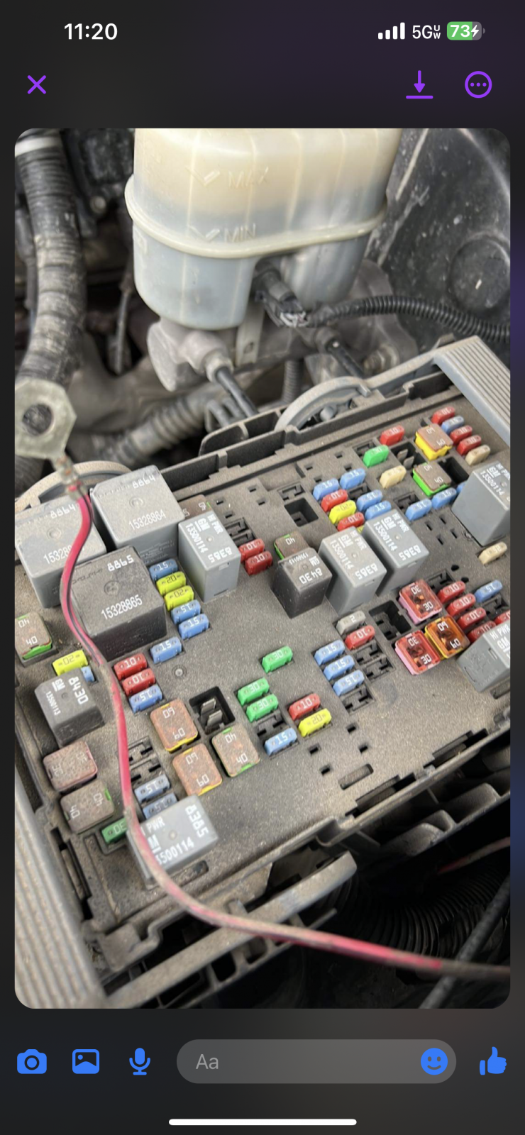

Checked fuse box for moisture absolutely none dry as a bone, swapped some relays around all look nice and clean.
Standing at the driver front tire fuse box in front of you the wire loom coming at the bottom of the fuse box between the fender and box has a red with black stripe wire big square ground looking head crimped on it I found it just electrical taped off to the side any help on that would be appreciated. This Tahoe does have remote start and loaded with the options no aftermarket radio. Will also state after this occurrence I had an hr drive home she shut off like normal instantly.

Might want to check if it has remote start. Sit in passenger side hit lock button 3 times see if it starts up. Any 4 door lock button can stop and start it . Mine has that . It's a dealer installed remote start is what I was told . At first I thought it was possessed. lol.
It does have remote start

Ya, definitely check the remote start system and any damaged wiring.
I was going to suggest pulling the fuel pump relay when it does that. Recently on one of my trucks one relay apparently got stuck on, I think it was the headlamp one. I could not shut them off no matter what. I swapped another known good relay and issue went away.
