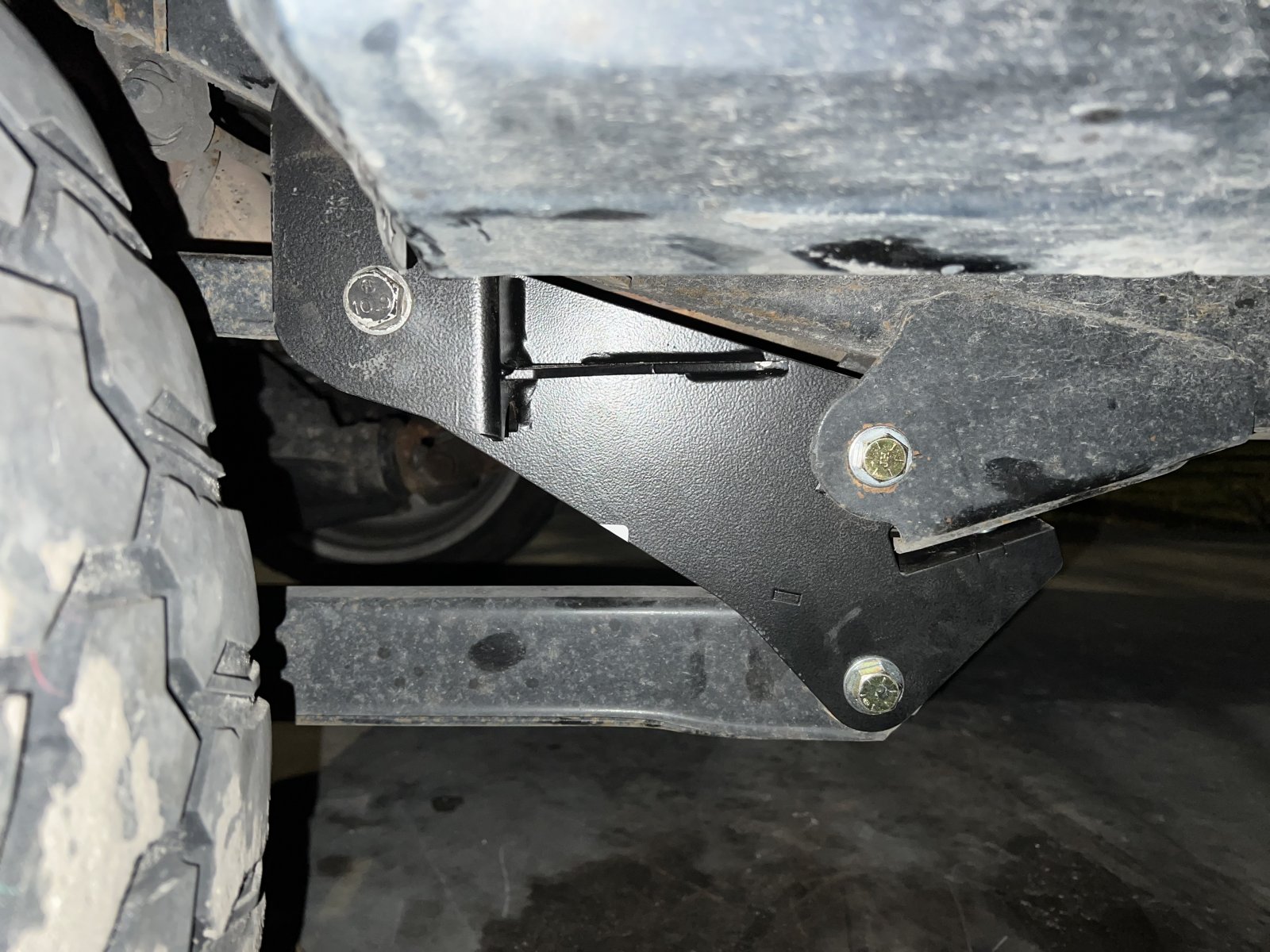

If you’re not running over a 5-7.5” lift you should be fine without the drop brackets but the panhard bar would be a definite.
Here’s some pics of mine
Start with the east stuff
(shocks coil overs sway bar links)
And go from there
Also I swear by the kryptonite suspension if you ever go to replace the hubs lower ball joints tie rods etc
The dirt king fabrication locking alignment cams are nice to have with the uniballs also after cutting the bump stops so you don’t have to worry about knocking your alignment out of wack over a bad bump.
If you need any help or got any questions just give me a shout I’ll do my best to help you out
