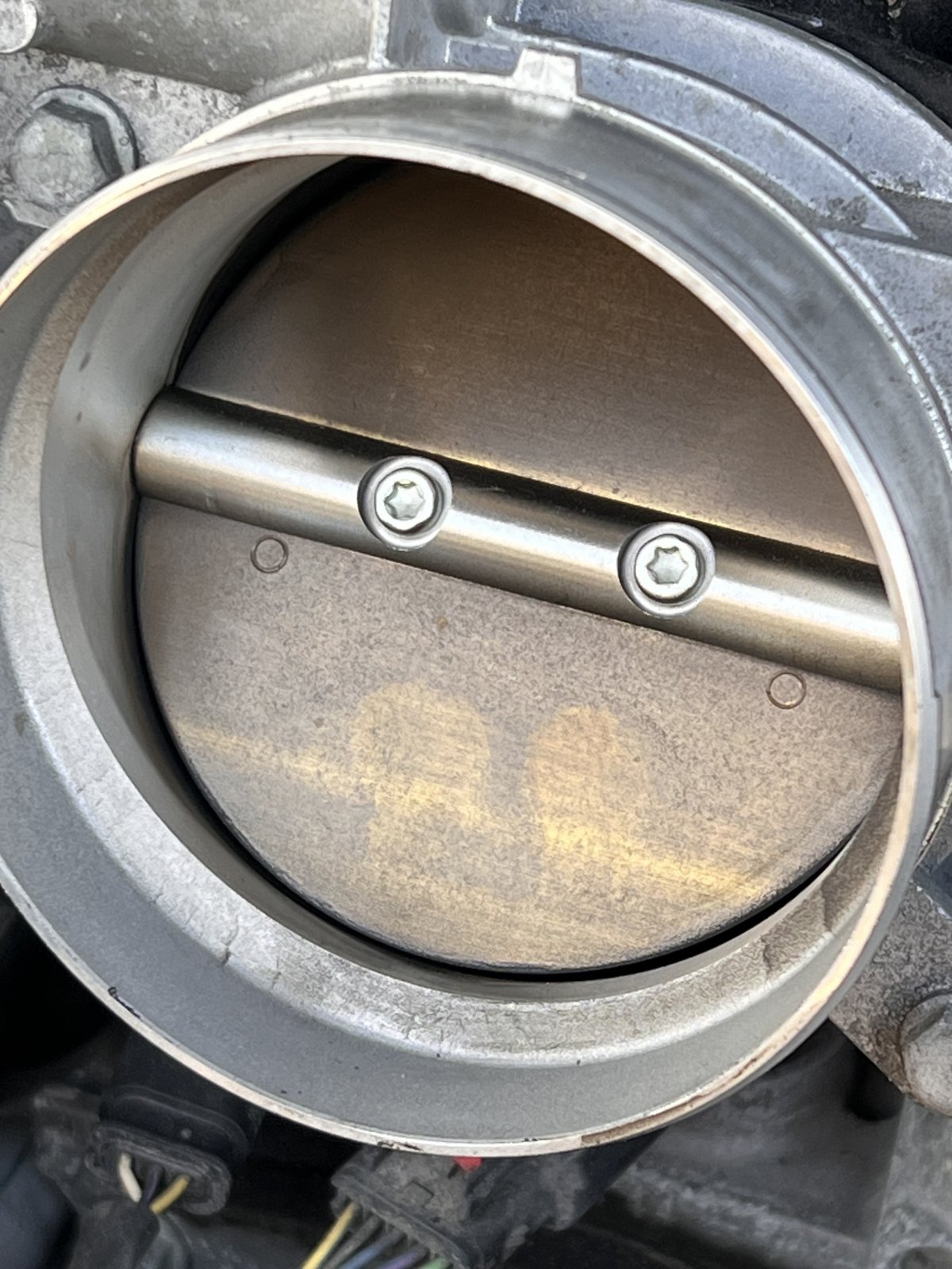

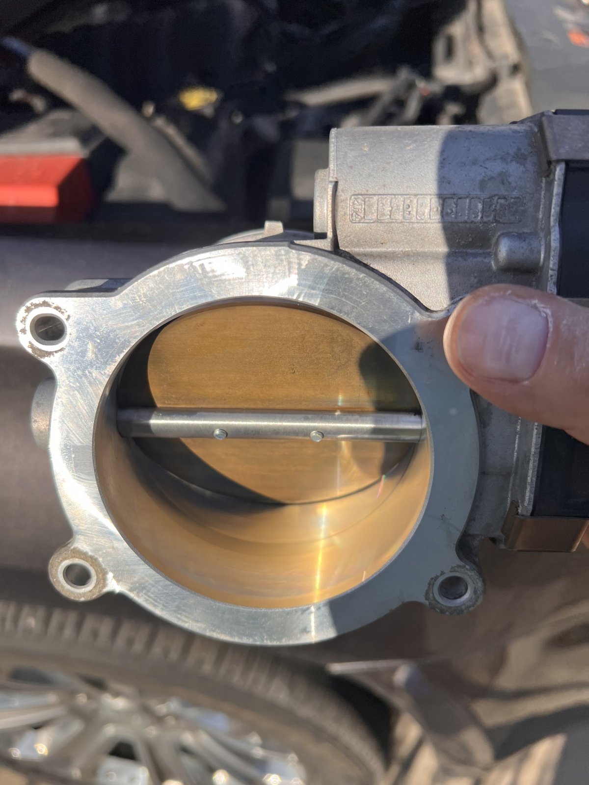

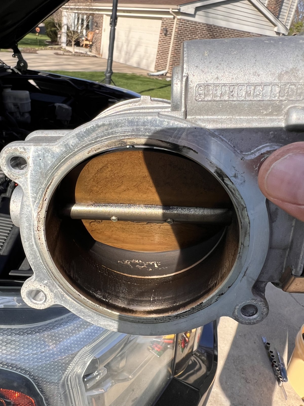

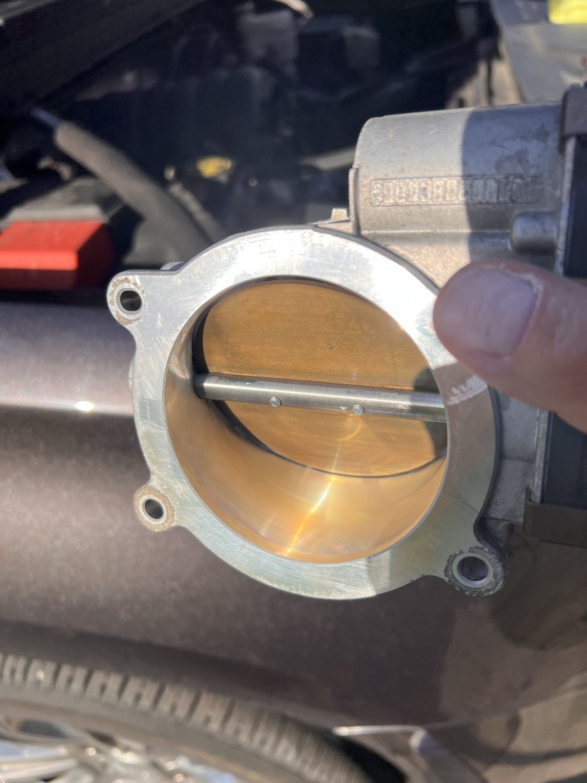

Hello all,
Sharing some pics of cleaning my throttle body at 140k. I have never cleaned it before(on this truck) and was a bit apprehensive after reading so many say they had issues after doing so - high idle/ unable to get it to relearn…..I had no issues.
I bought a new TB gasket, and went for it….
1 First disconnected neg battery cable.
2 Removed intake cowling .
3 Disconnected ETB connector.
4 Removed 4 10mm bolts for TB
5 Cleaned plate and body with soft towel and TB cleaner- yes I did gently move the butterfly plate to get all surfaces.
It was dirty, but not awful. When I hooked it all back up an and started it, it idled normally and drove fine.
Maybe some are really aggressively moving the plate open and closed or getting cleaner in the pivot pin area/ electronics inside?
