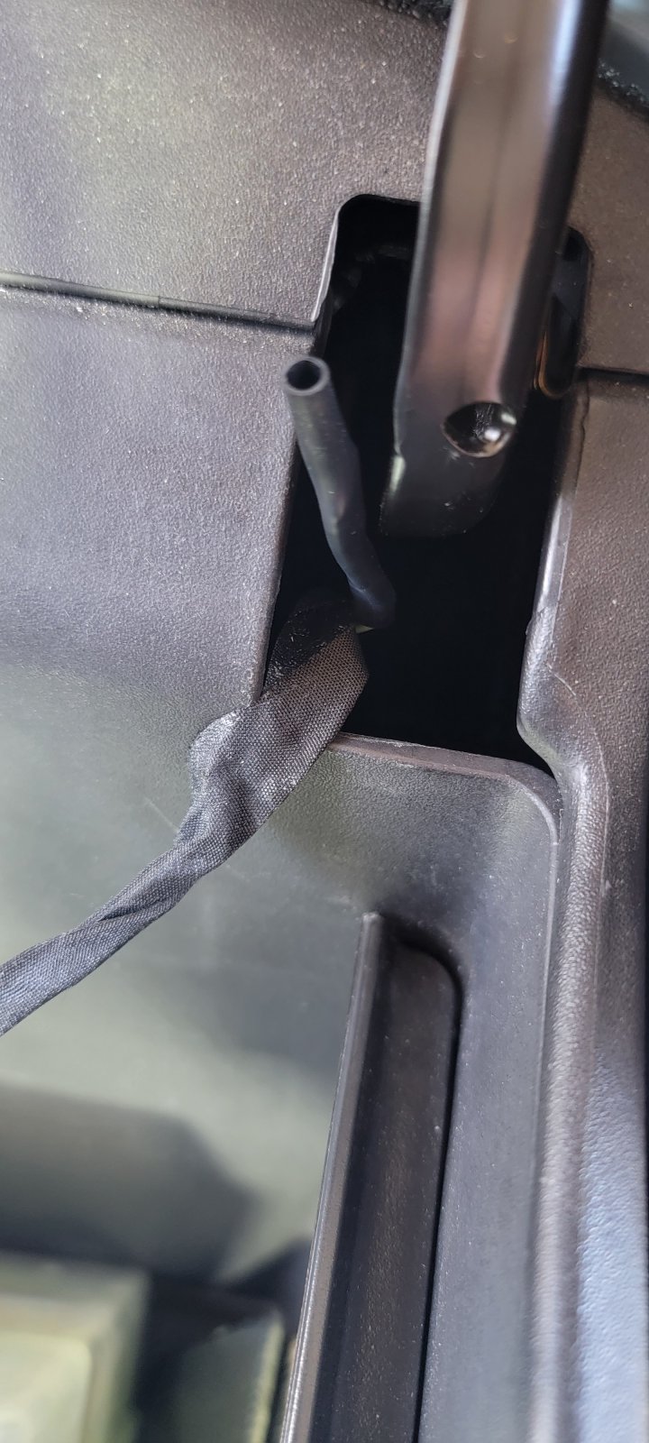

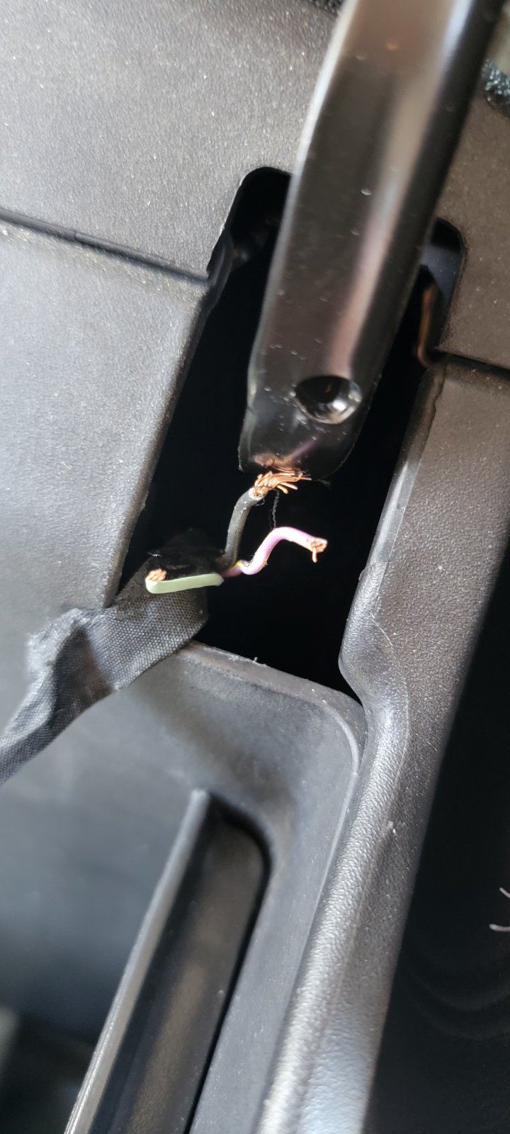

This was posted in the Electronics section, it may help. "I had the same issue...#8 blowing continuously and sunroof stopped working. The problem was the wire harness going to the wireless charger on the console cover. The wire insulation cracked at the hinge, so every time I opened the console the fuse would blow. This was on a 2016 Tahoe. Discovered it when the console smelled like an electrical fire"

Had the same issue on a 2015 Yukon SLT. Drivers side fuse panel #8 was blowing.
The wireless charging lightning bolt was on all the time and then discovered the sunroof wasn't working.
Removed the back panel of the center console and noticed the harness on driver side was steeply bent, and yes, two of the three wires were broken.
Reconnected the wires and presto, no more blown fuses.
