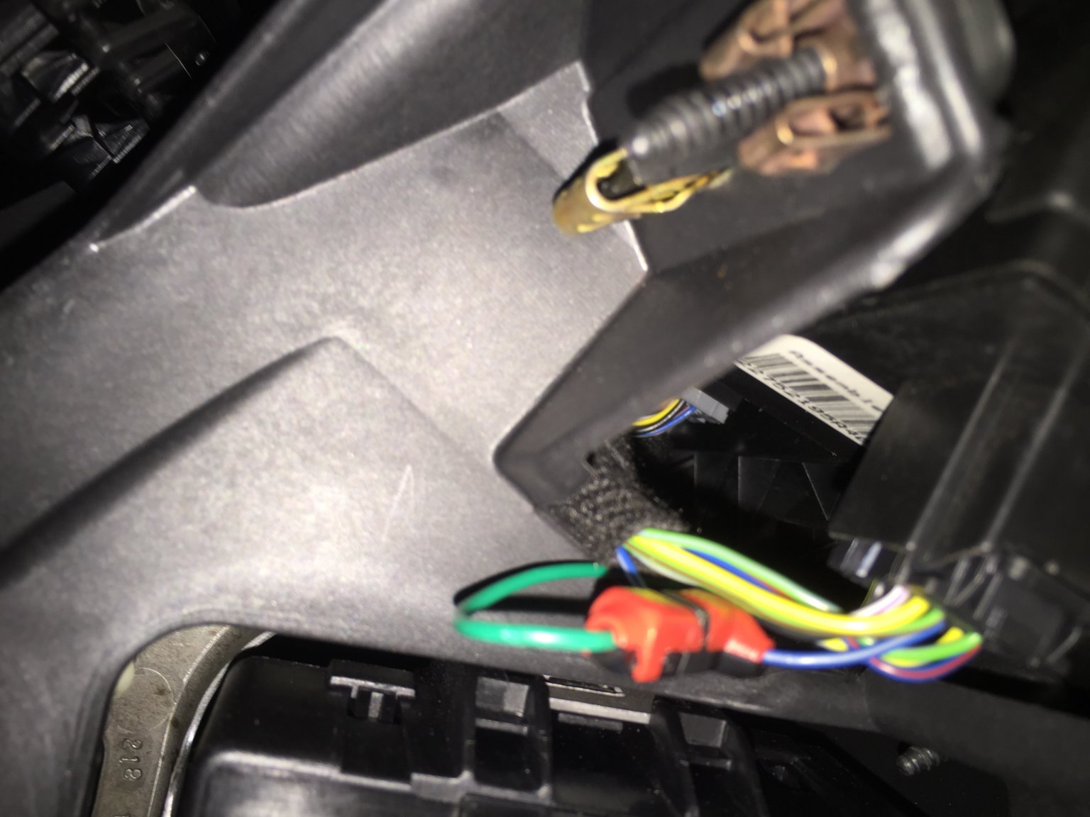

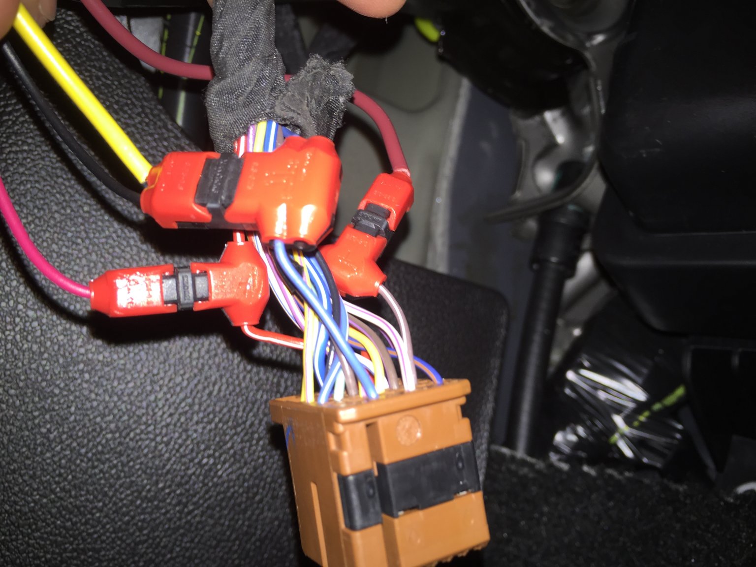

Any pictures of your connections from the foglights to the 611T and of it wired to the BCM? Great write up, i just want to get some visuals of what im up against.
