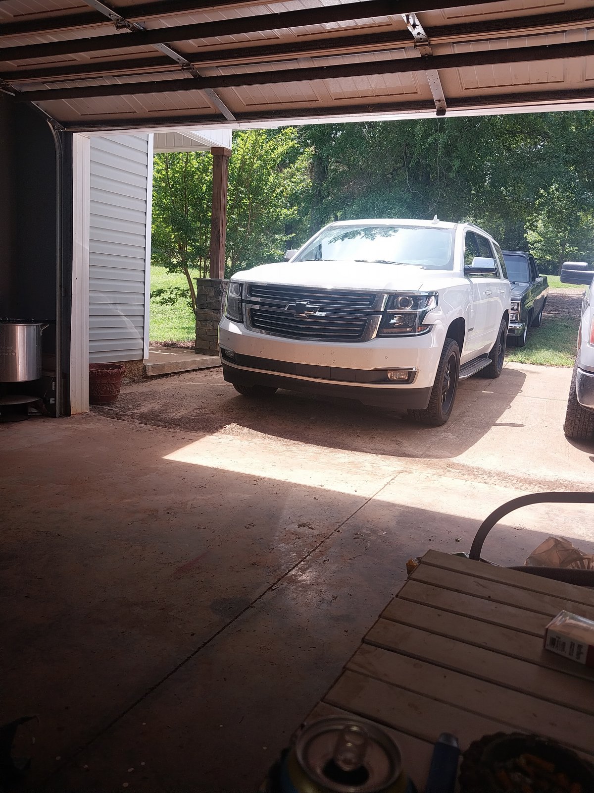

Hi I'm new here, have a 2017 tahoe premier 2wd .2yrs ago lowered rear 2inchs it had just a little rake. Just replaced the front electric strut assemblies (rpo z95) now the front sits 2inchs higher, any thoughts on why would be greatly appreciated. Thanks

Pics of the truck, please.
Did you replace the springs as well when you replaced the strut assemblies? How many miles on the truck?

Yes springs where all ready on the struts and 75000 miles

We're they GM magnarides you replaced with? Or were they aftermarket?

If the struts were aftermarket, then I cannot assist you. What happens if you reverse the original lowering of the rear suspension?
