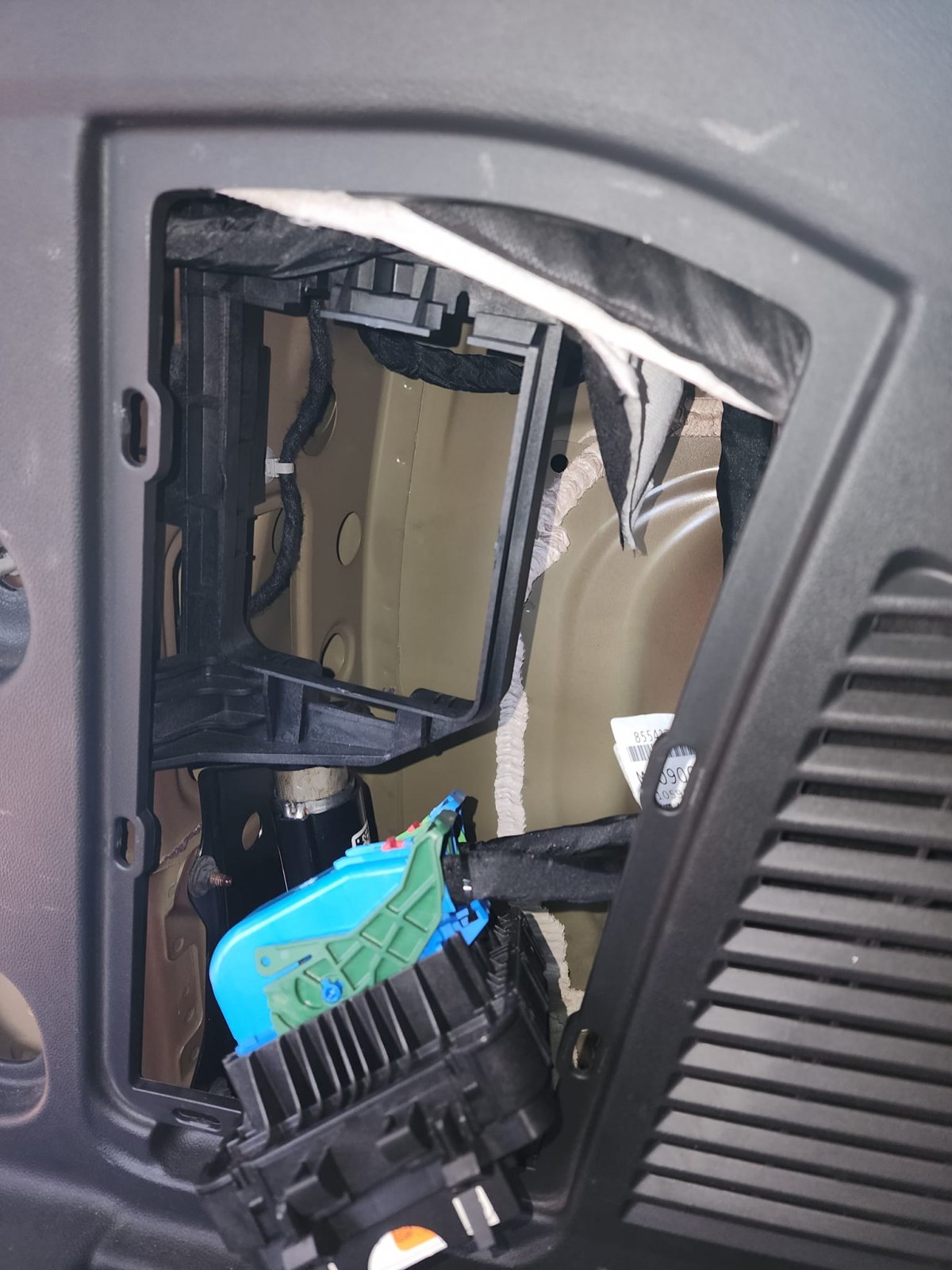

Based on your image as well as I can only assume the subwoofer wires will be thicker....I think I found the target. Thanks GMC for making me taking out the entire hatch area flooring, rear speaker pillar.....to get the side panel able to flex out enough to get back in there.

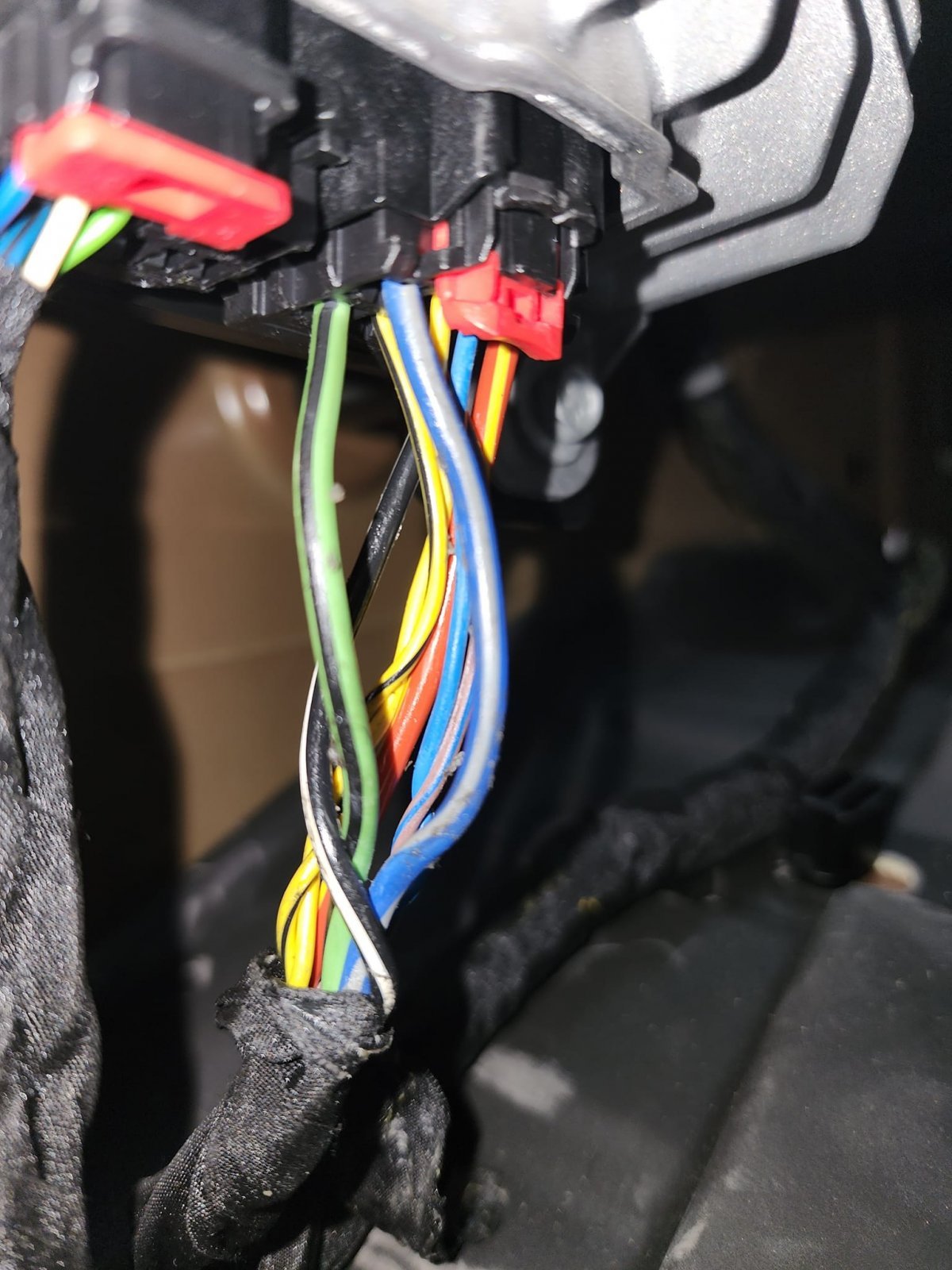

The Green w/Blk and Blue w/gray pin next to each other. While the Black w/white is in a different position on that connector.
I'll assume the Green is positive and Blue is negative?

I would poke the wire with a meter and check to verify polarity, no telling by the color anymore gm does whatever gm wants as far as wire color but they have been "better" with black being a ground more often.

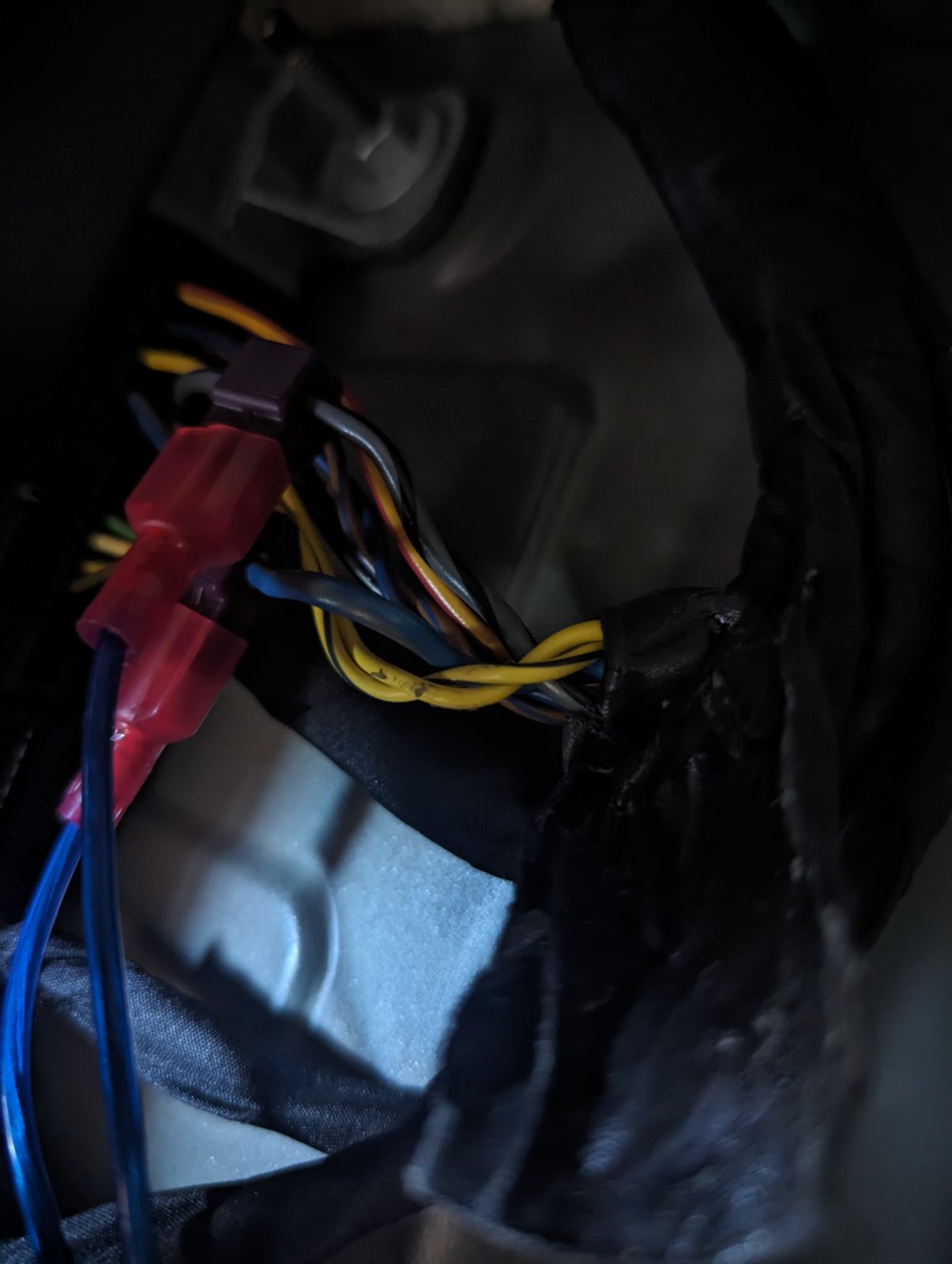

Lucky you LOL....pointing to where the harness is around.

Would you assume my thinking is right that those are most likely the sub wires due to size?

Most likely, I was actually surprised it was so easy to get to on the 16, on the Silverado you have to pull the backseat out, you can kinda reach it from under the seat but can't see anything
