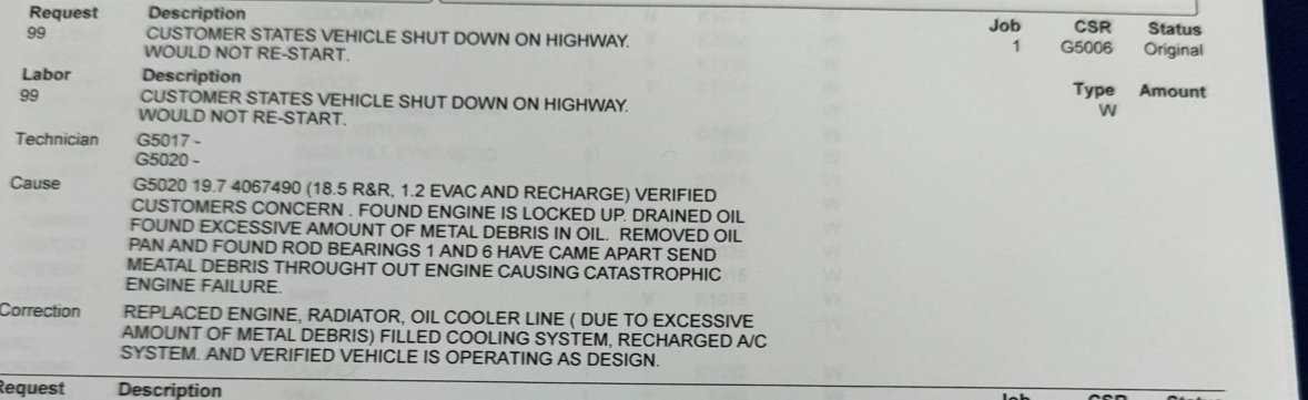

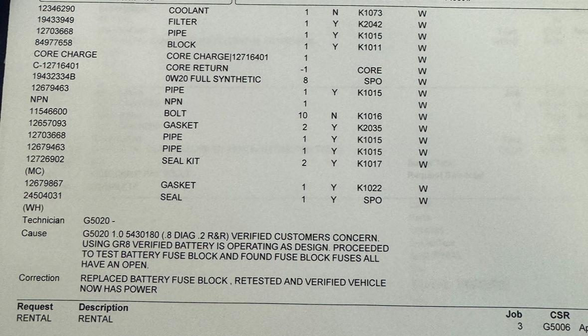

Here is another question - is an exhaust smell normal with a new replacement engine? When it idles it smells like an old car
D
Dangler6131
Apr 9, 2022
24
I wonder if this a new engine, a long block, or a rebuild? Sure a shame to do a heart transplant on a brand new premium machine.
Unsure. Here is what work order said
