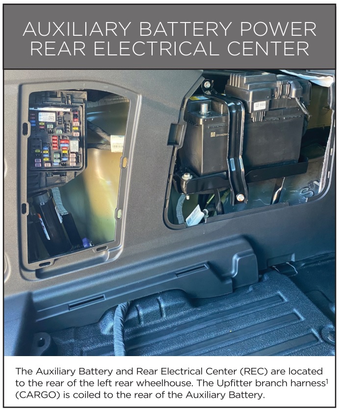

has anyone installed this or know anything about it? i can find diagrams of it, but not where it goes, what size battery it fits, etc.
thanks!

except they redesigned the front body of the truck, adding lots of heft where the battery used to go?

Yeah, no room there. The read kit I pictured is a better spot for my use but I can't find anyone who has actually installed one .

I have looked into the aux battery placement on the current generation, and from what I can tell, it is mounted behind the driver's side panel in the rear cargo area where the subwoofer would normally be. I found some information showing this in the PPV documentation. It appears that the aux battery for PPV applications may be a lithium ion battery that is about half the size of the main battery. I'm having trouble finding the documentation where I saw this though.

Yeah that's where it goes. I can't figure out how big the battery can be. I'm going to put a lithium in, but still searching for documentation. Called my friend at the dealer parts dept and part is available but they couldn't produce any documentation

I suspect the interior trim with the access panel is a police package specific part.

Thanks I'm going to try it. I'll just remove the trim panel when I put the battery on and put it back on when I'm done.
