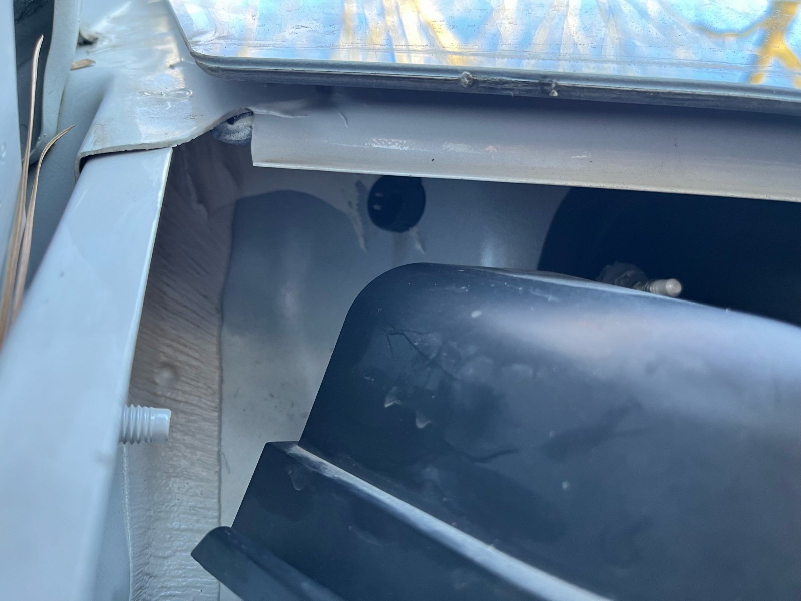

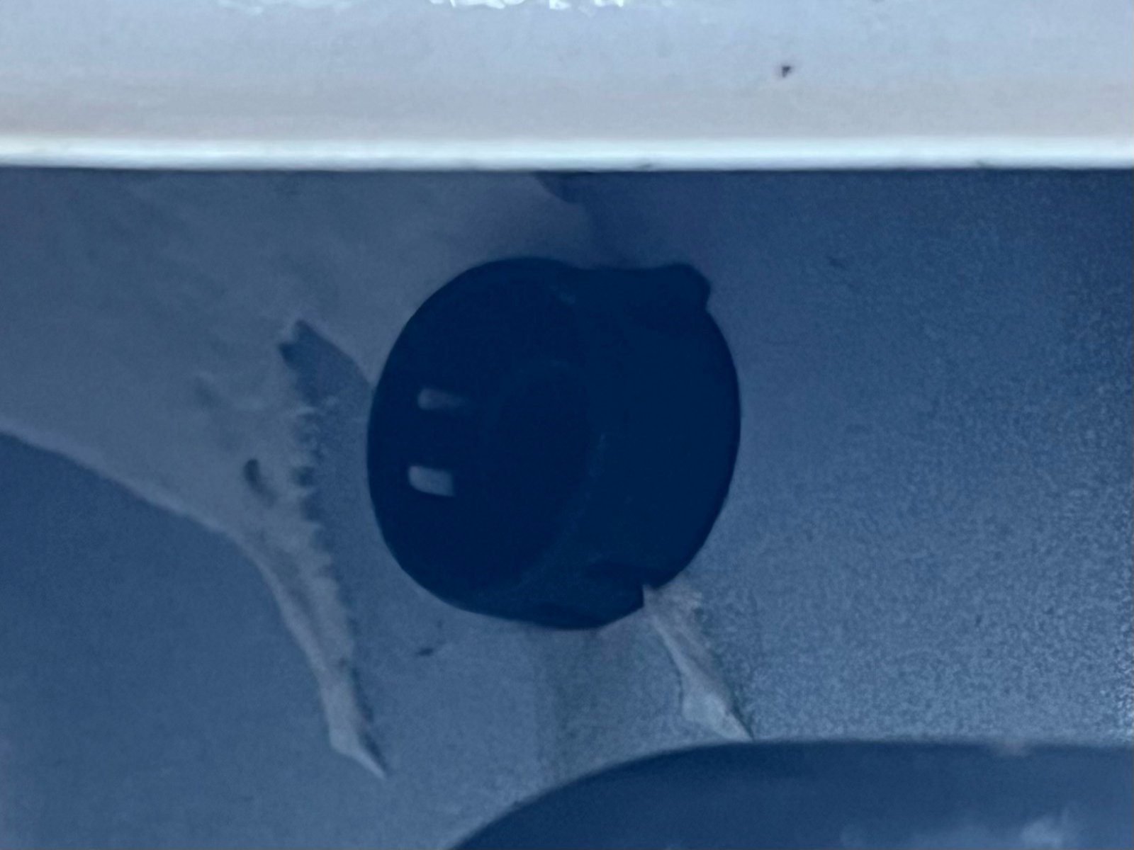

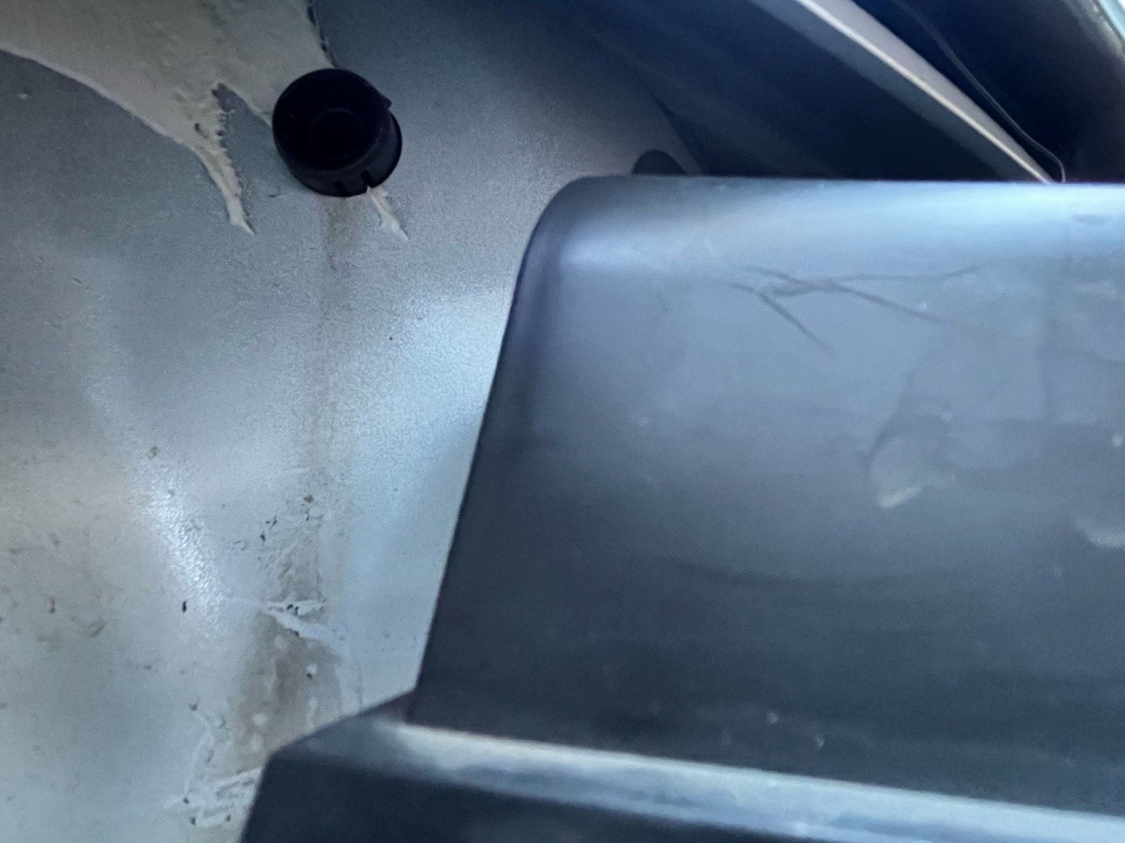

Sometimes I have the same, but at the rear glass.‍
VTJoeK
Jan 14, 2022
8
Do you have a sunroof? If so, it sounds like the water is not getting to the drain lines for the sunroof rain tray and jumps over the lip. Open your sunroof and look in the corners where the drain lines are located and make sure they aren't plugged with debris.
I do have a sunroof but the drains work fine. Thanks for checking.
