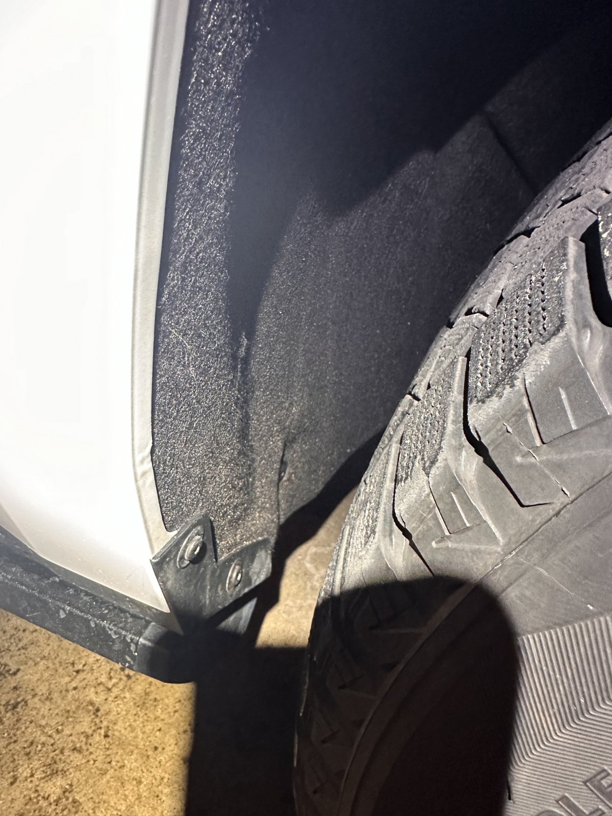

rims, on my Yukon XL AT4 (air suspension). I did use the Westcott Designs fender liner pullback kit with great success as there’s no rubbing at the rear of the fender liner after doing the mod and the front clears fine with no mod needed.

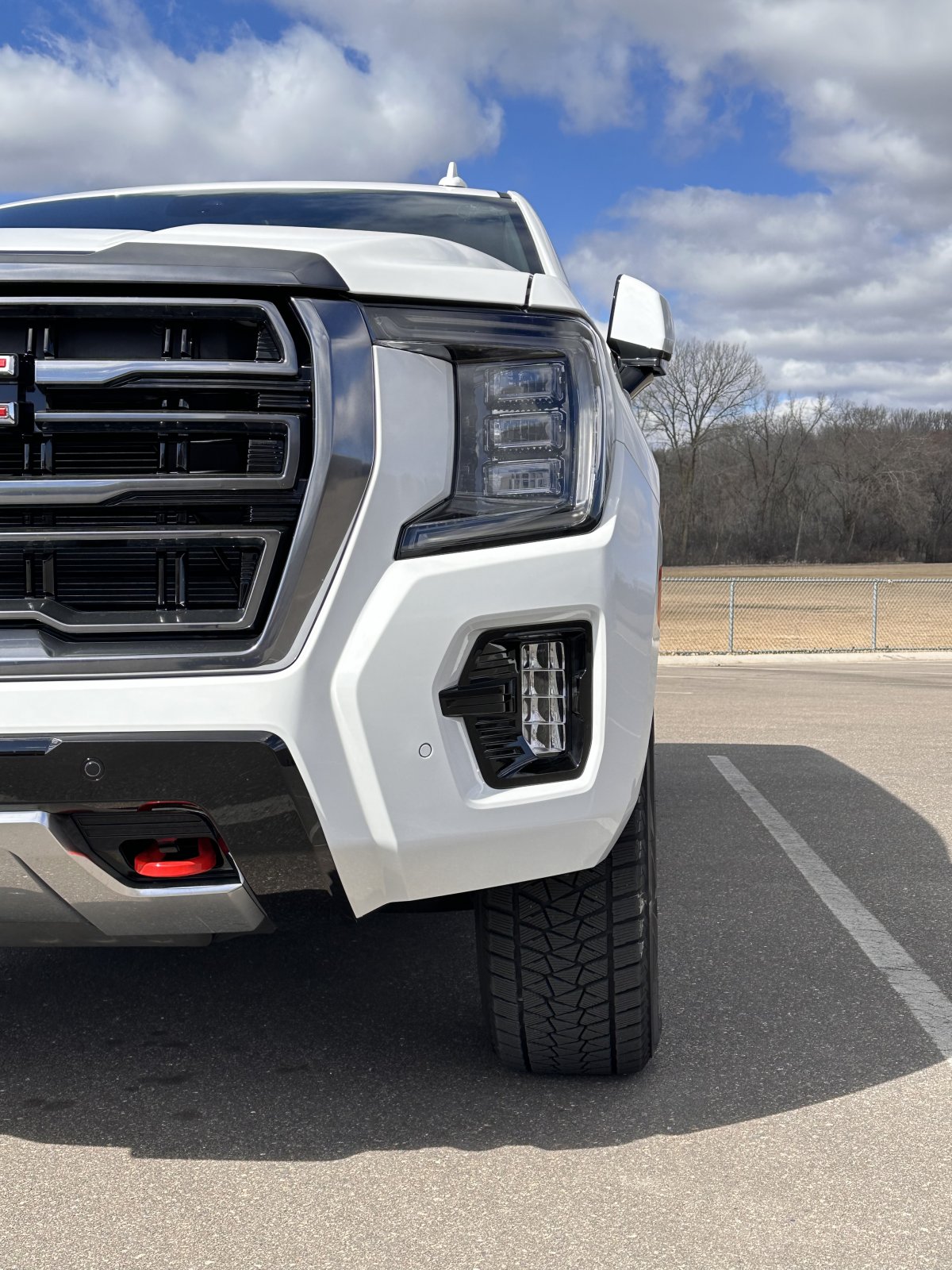

It’s hard to tell from the photos below but I took some before and after photos to show the additional clearance, which appears to be at least a few inches gained with the bracket. Pro tip: the bolts are metric and I believe require a 15MM socket.
After:

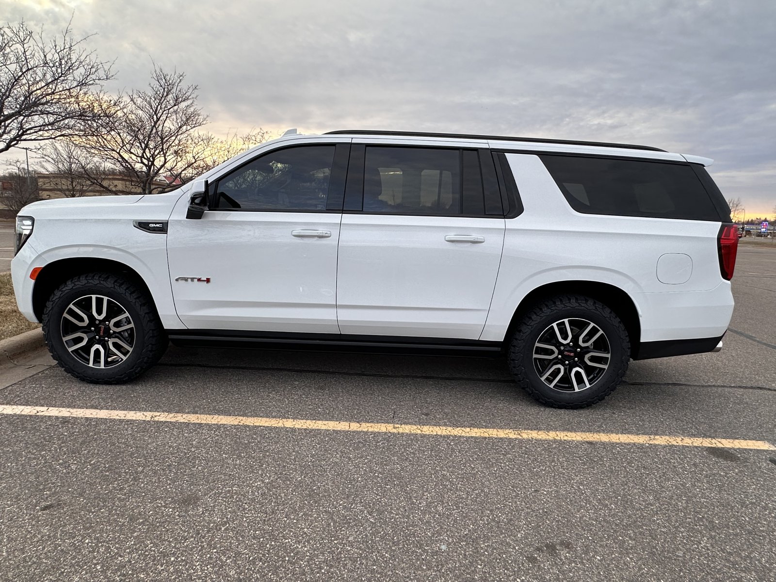

The tire in the above photos is a Bridgestone Blizzak DMV-2 but I just swapped over the OEM rim with the BFG’s mounted. After some extremely helpful feedback from @nick14226 regarding tire pressure and the calculator he supplied, I aired them up to 45 PSI and had them bolted on.
My initial thoughts are the truck rides a lot more stiff, which I’m not sure how much is due to the LT BFG tires or the fact I switched over from my soft snow tires. I’m guessing partially because of both variables. Overall road noise is non-existent with the BFG’s which is a testament to the sound-proofing on these new rigs. Handling, while a little more stiff, is still quite remarkable.
In the looks department, this is EXACTLY what I was hoping for. It give the truck a great stance without any crazy mods or downsizing rims for a bigger sidewall. Also the off-road performance should be profoundly improved vs the stock off-road “pavement princess” OEM Goodyears.
OEM profile:
BFG 285 profile:

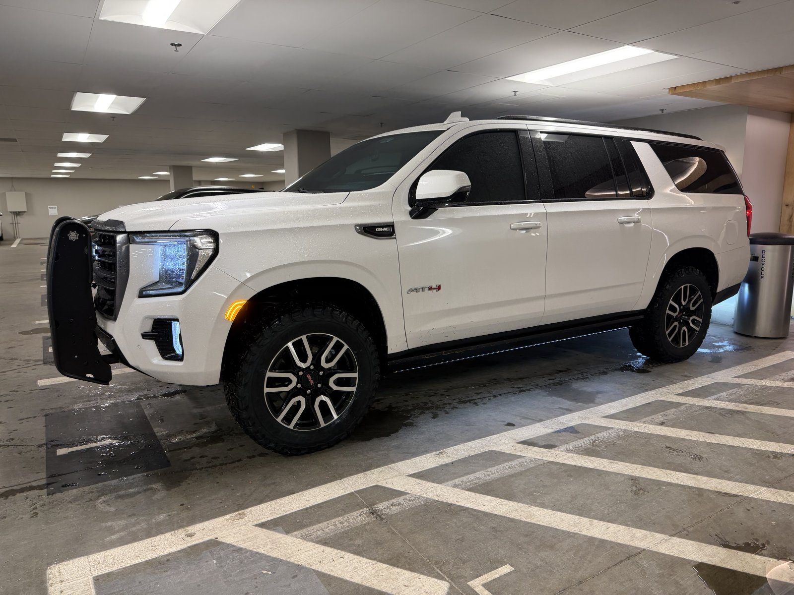

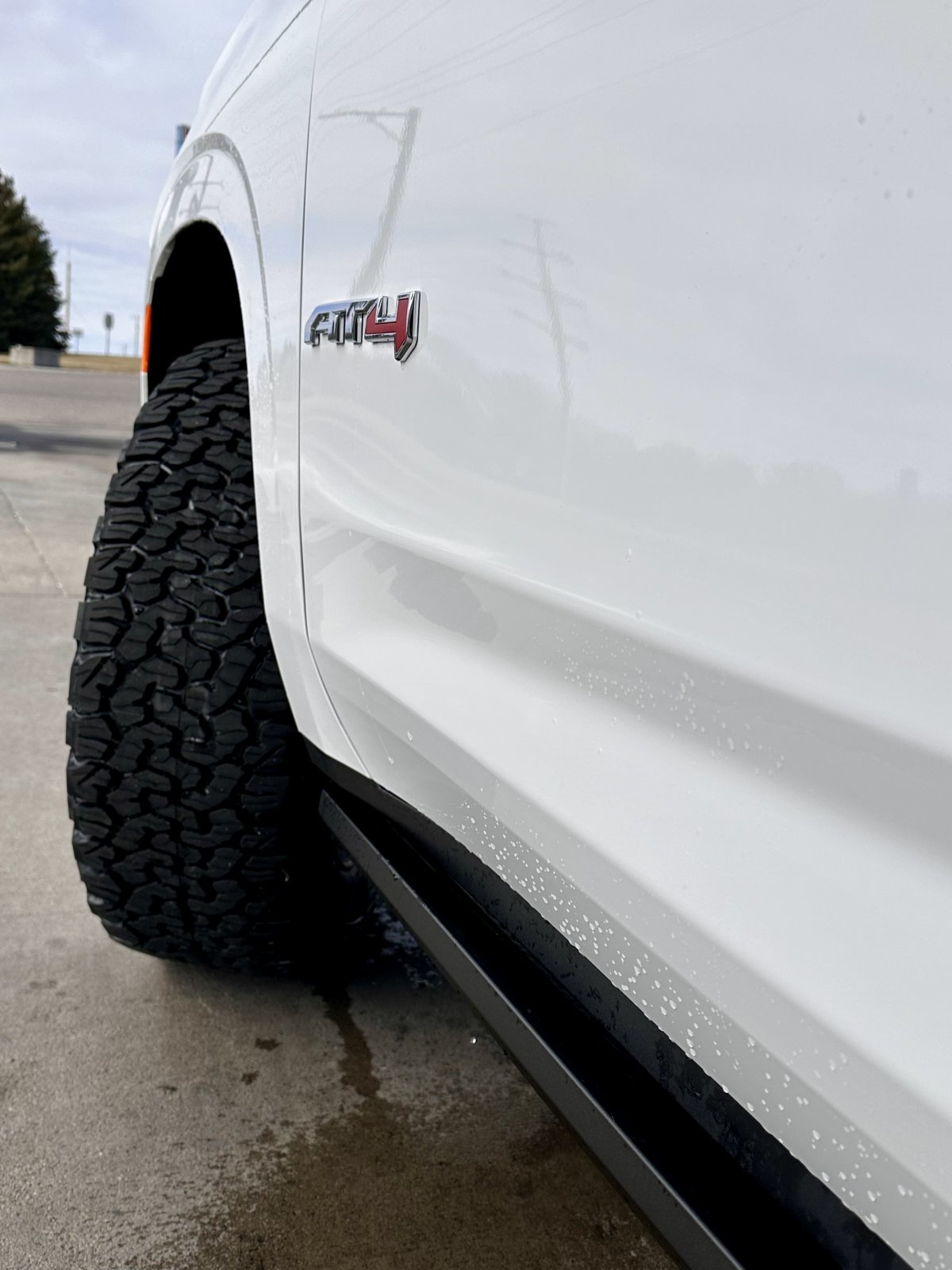

A few other photos (BFG 285/60R20 left and OEM Goodyear Territory 275/60R20 on the right):IMG_3300.jpeg
