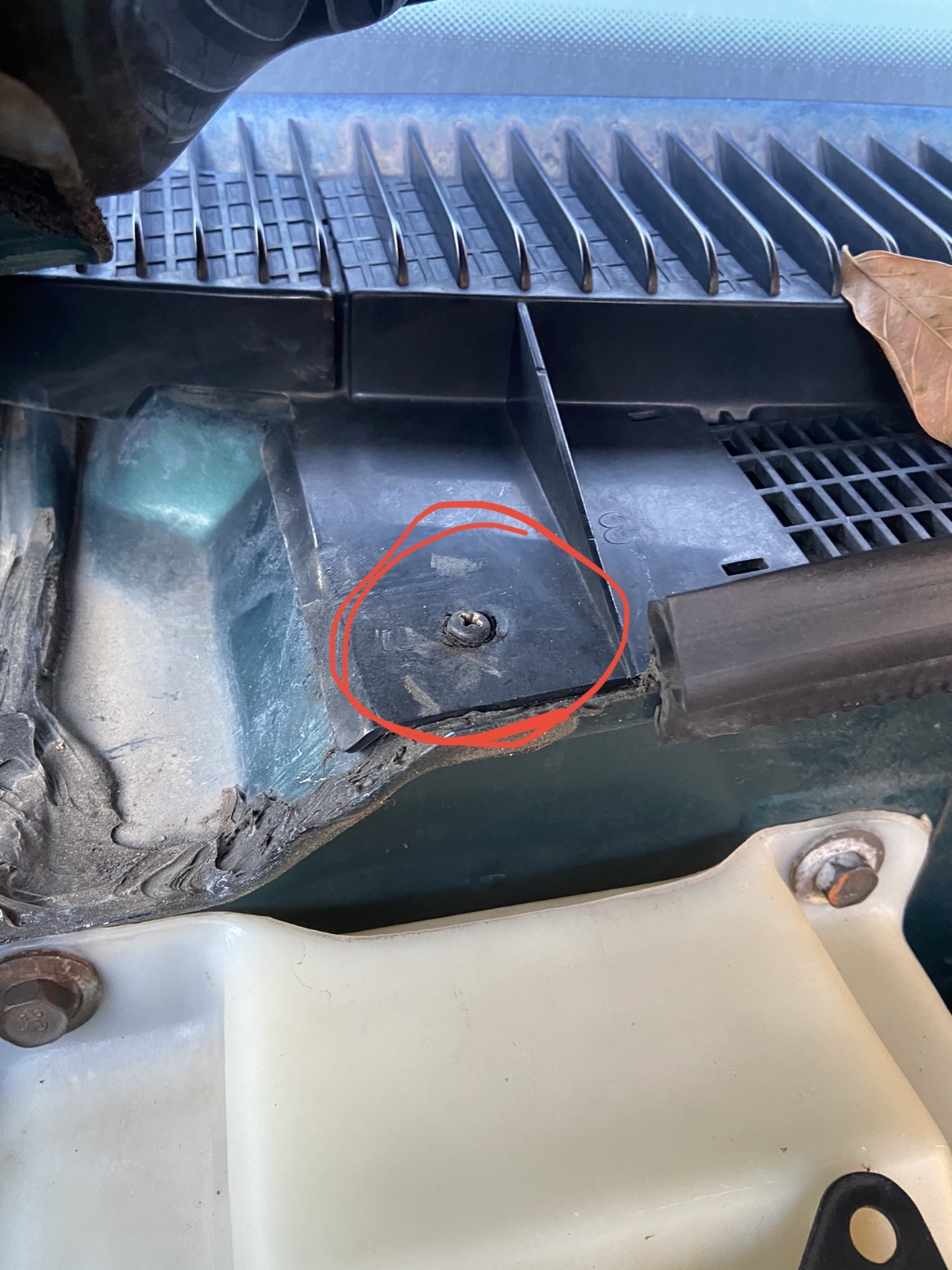

The passenger side can leak through this screw down into the blower intake. It doesn’t really sound like your issue, but doesn’t hurt to remove it and reseal the screw.
On my 98, the sill plates filled up by bad weatherstripping on the passenger side. On the driver side it was weatherstripping, a leaking rear window (two door) and also rain splashing out through the inner door vent behind the door panel.
In other words, a water hose test would be your best bet to spot the leak - admittedly not too appealing if you’re in a snow storm.

took cowl off and looked into it,still leaking.matt under rug is so soaked,dyring it out now in dec..lol
