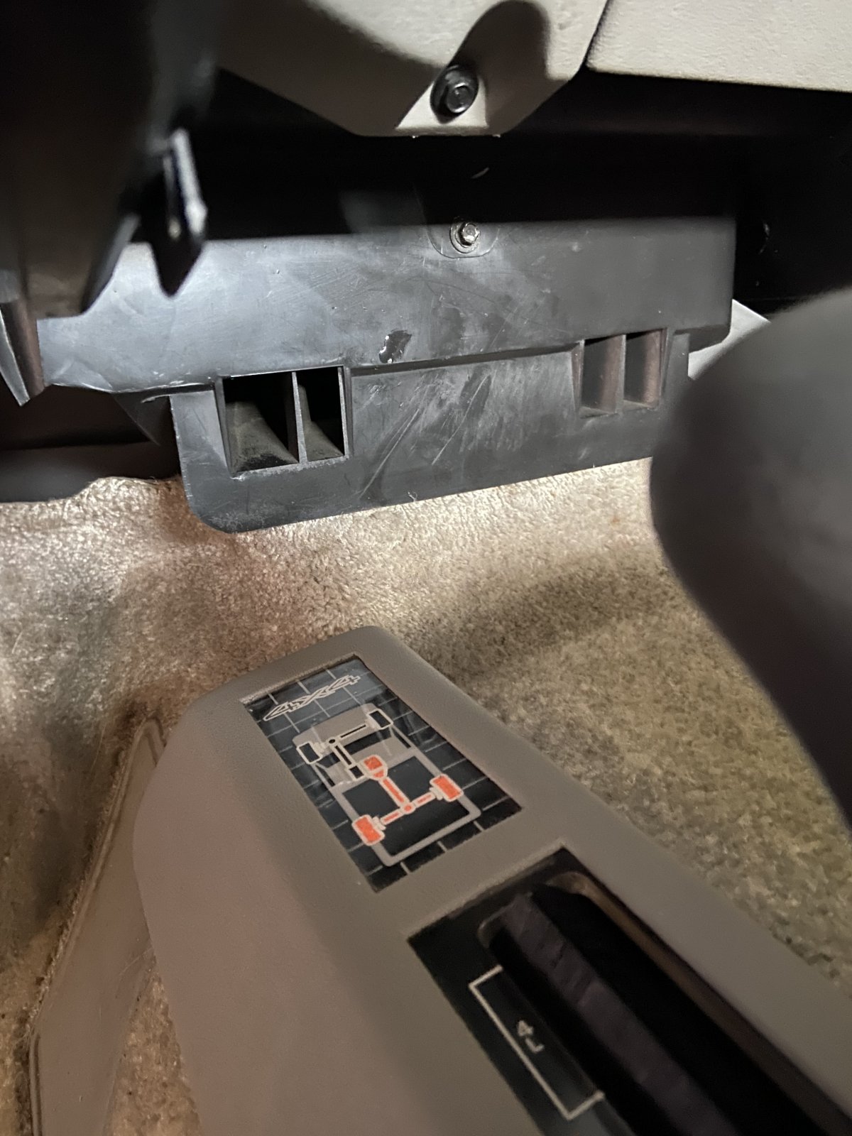

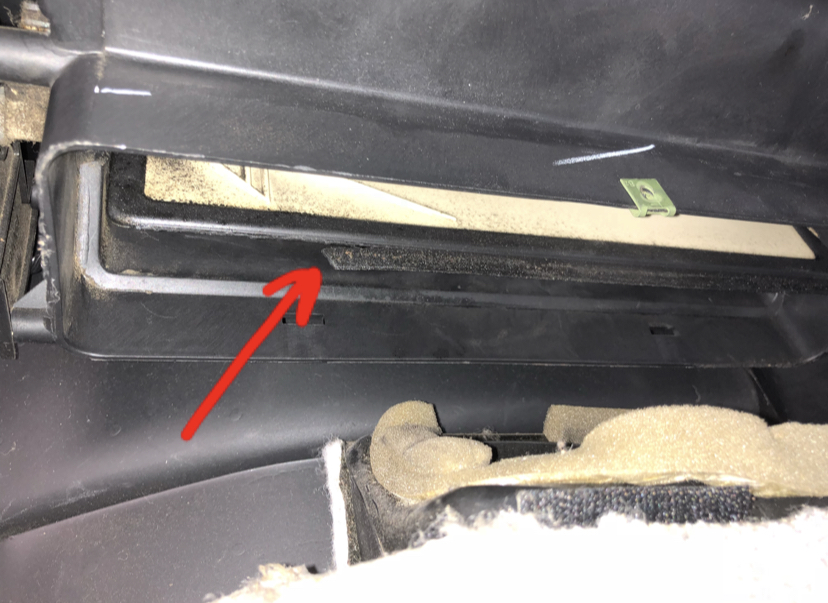

GM would argue that he does have rear heat…it’s just slowly seeping through those little vents on the floor. You could pull the cover off and see if the foam at the floor duct is shot, but it’s probably one of those “as good as it gets moments” if none of the other air dampers are leaking by elsewhere.
And they probably are. The rubber perimeter on them comes apart after a few decades, but you have to pull the dash to get to them.
Picture below shows the foam along with a torn damper, but that’s more critical for a/c since it lets cold air onto the floor when it’s supposed to be closed.

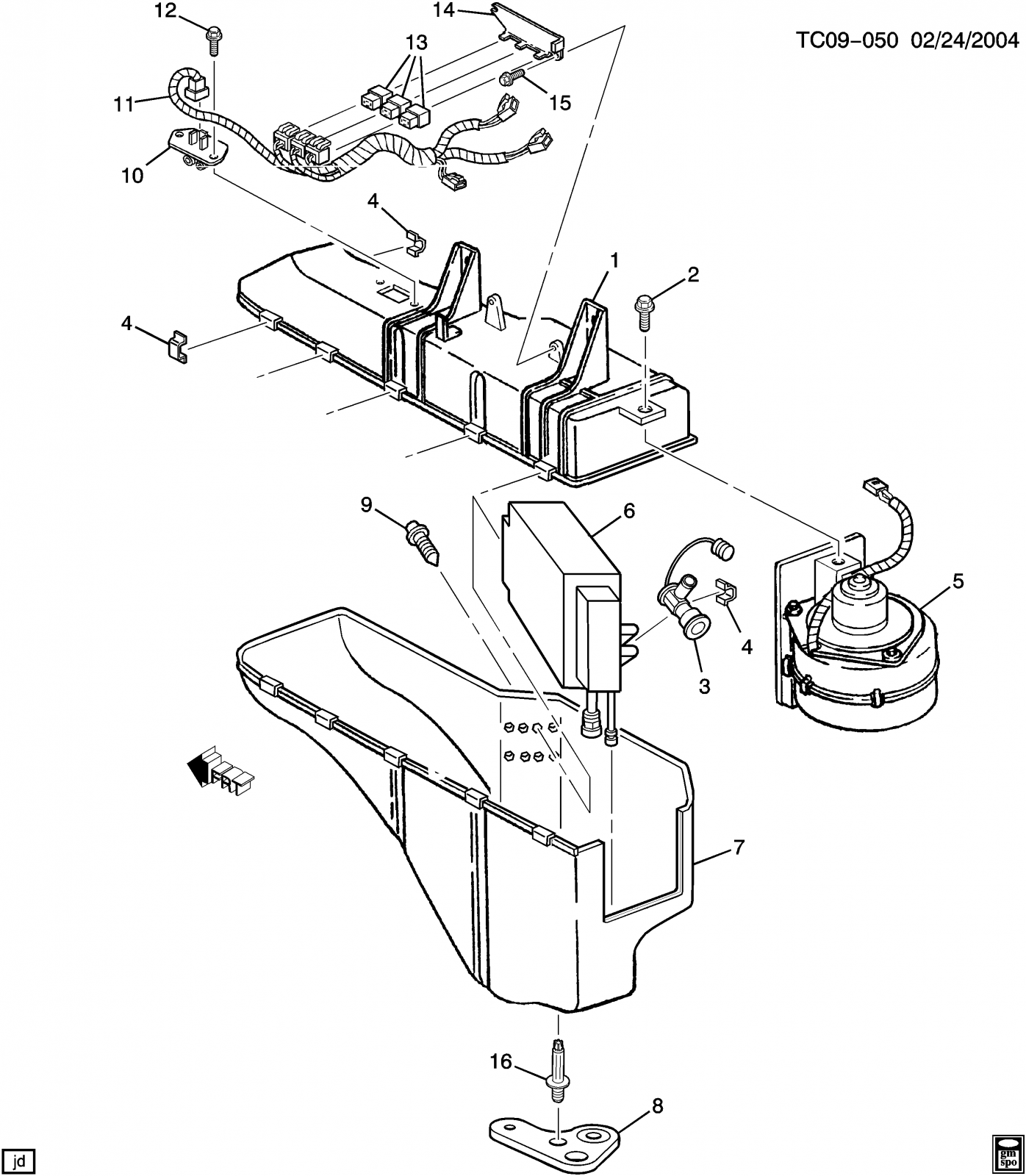

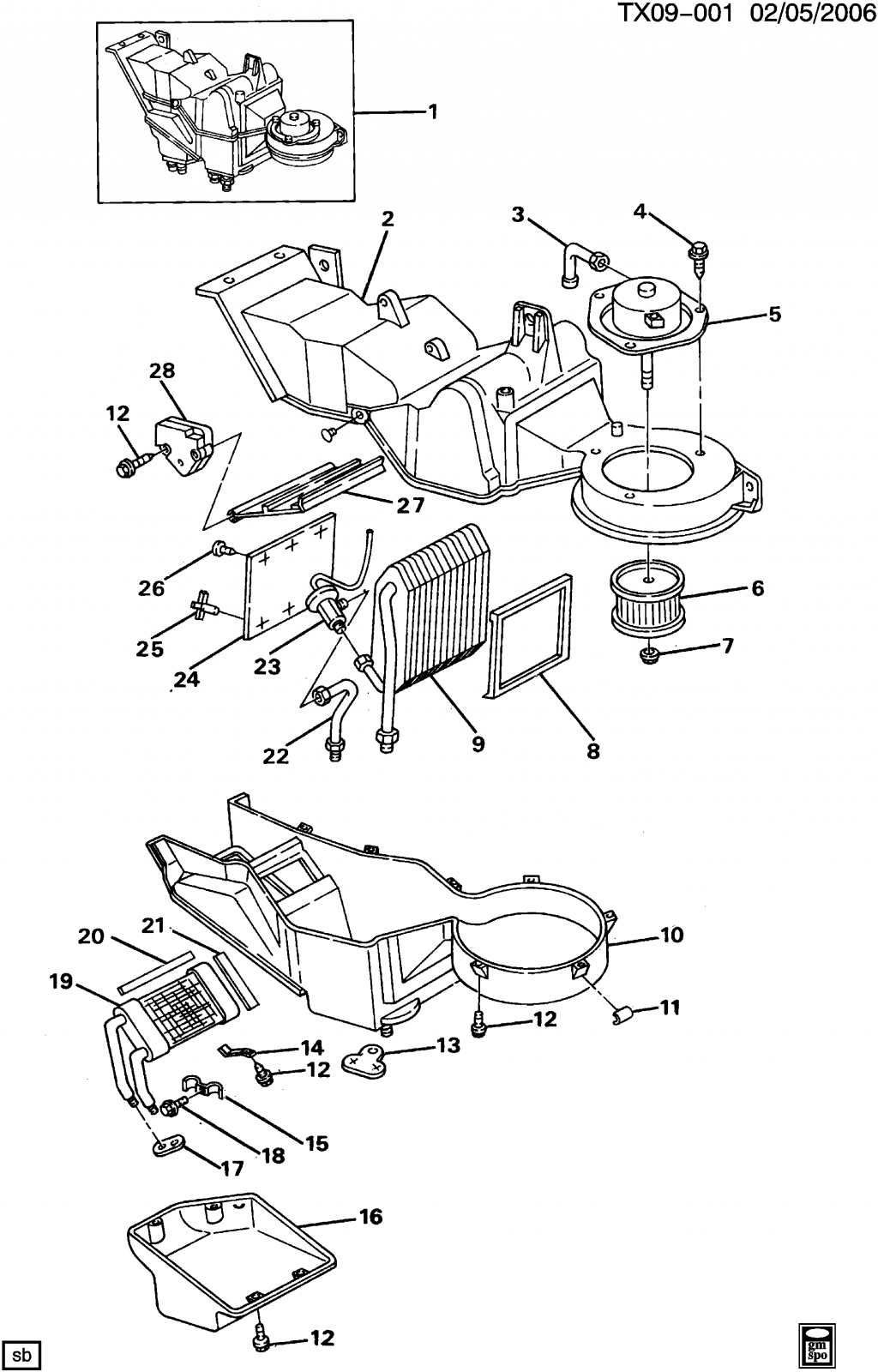

As for swapping a heat and a/c box from a Suburban into a Tahoe, I suppose anything’s possible given parts, time and money.
Tahoe box (evap core only):
Suburban box (evap + heater)
Getting the heater hoses to a donor box from a Suburban is likely a wash compared to aftermarket. The main hiccups would be “would it fit” and how to wire it up.
