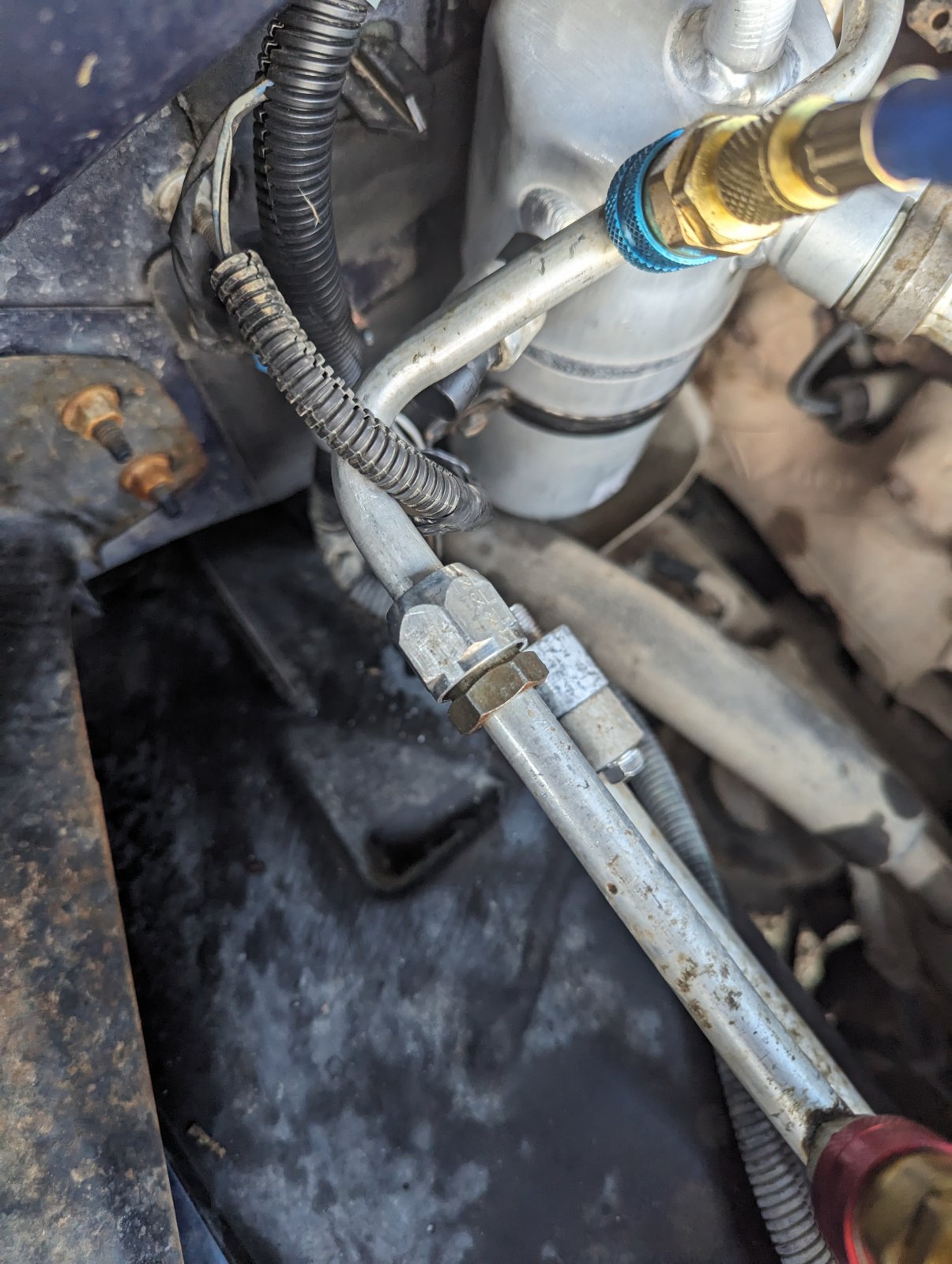

I found I had a small leak on my rear ac lines. So I bought a rear block off kit.
Replaced all the o-rings, flushed lines and put in a new drier...
I think I have leak from this connection
Where I thought I would find an orifice tube...but there was only an o-ring... Is there anything else that seals that joint?
