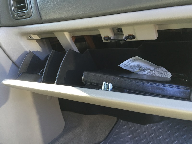

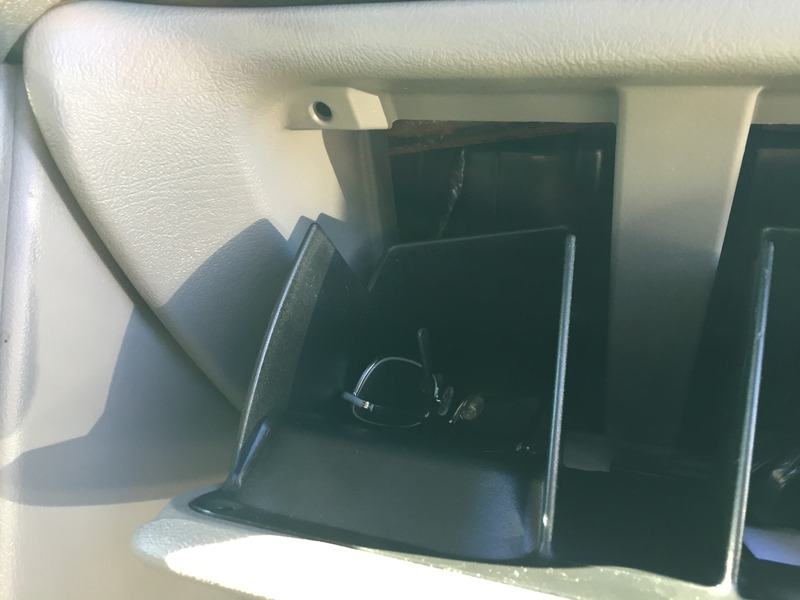

Go to best buy and get the Isimple brand module. 179$
Its plug n play and gives you a Ipad, Iphone, Iwhatever plug AND and 3.5mm Female jack to plug any other audio device into.
If you have OEM nav it also has video hookup for aftermarket video whatever..
I hid all of my plugs in the cubby below the OEM radio, along with the bs switch that turns the unit on and off..
If I didnt tell you it was installed you wouldnt know. Pics inc..
