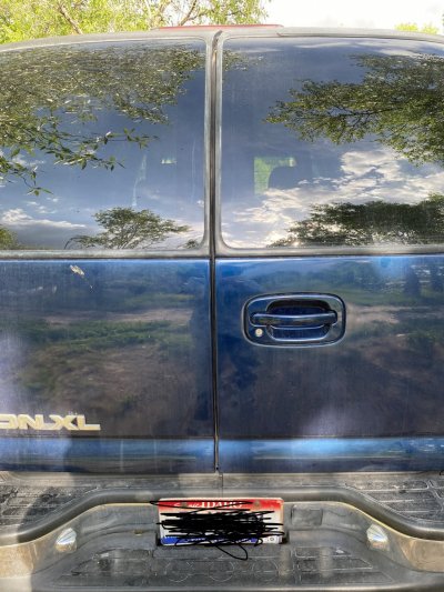

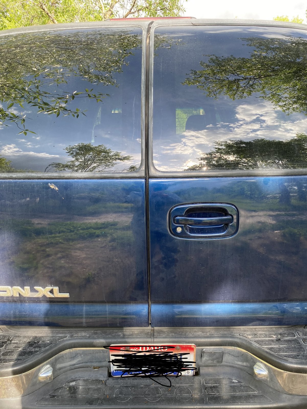

ok, another update. at this point, its driving me a bit nuts. i got everything where it seemed to be correct, and now im getting wind/road noise again. i am going to push the drivers top out, and bottom in. it seems like the bottom latch isnt catching all the way. and from what i can tell, there is no real adjustment in the latches. im trying to hold off on just throwing weatherstripping at it, because it appears to be in good shape and its not cheap from lmc.
other sources for weatherstripping?
Moosemoon
Mar 22, 2023
104
130
I know this is an older thread - but did you get it fixed? I have same problem
