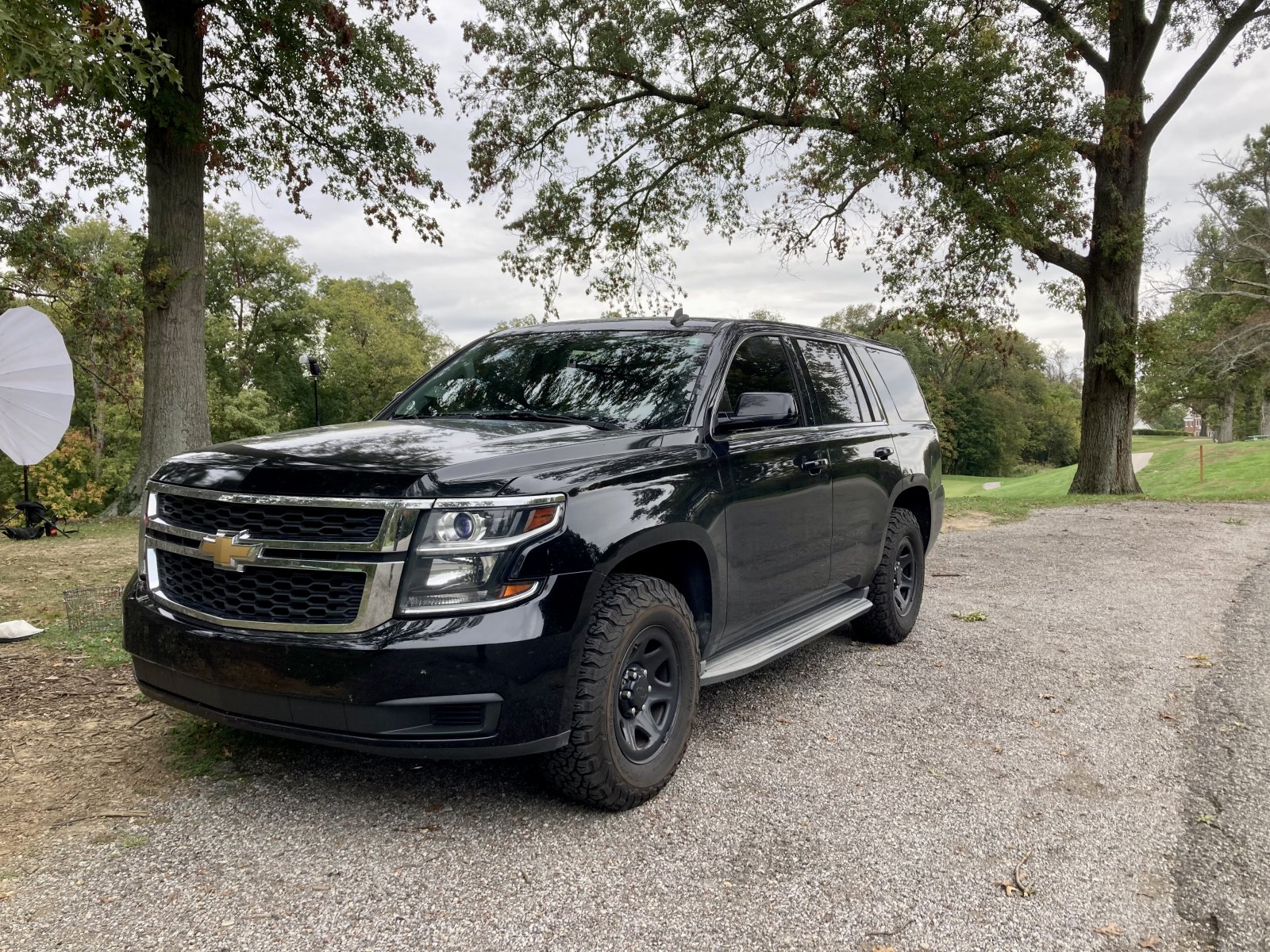

I need new tires for my 2015 PPV and I am looking at the bfgoodrich all terrain ko2 but I would like a bigger/taller tire than P265/60R17 - They just seem too small
Are there any other options for a stock PPV?
Thank you in advance.

I put 20" Silverado rims on my '14 PPV. Tires are 285/50/20 and they rub only in extreme turns

265/70/17 should fit just fine and is about the same height as a civilian Tahoe. It’ll fill in all that wheel gap the ppv has with stock size tires and give a nicer ride.
I have a 2010 ssv so not a direct comparison to your 15 ppv but running 265/70/17 ko2’s and it’s lowered. Rides great.

I run 305/50x20 tires on stock 20" wheels with no rubbing. My spare tire is a 265/70x17, and I have run this tire on my truck with no rubbing.
