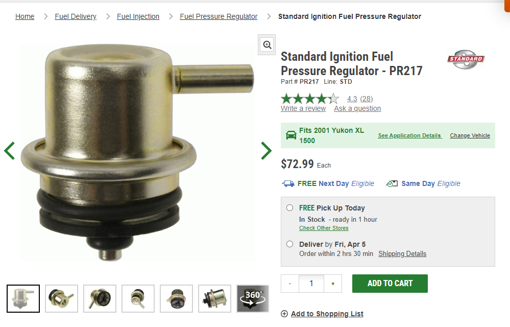

I had a similar issue, though I don't use E85. I could sit and crank on it for a bit and it would eventually fire up. I determined it was just not getting enough fuel initially. After some research, I replaced the Ignition Fuel Pressure Regulator. I was slowly leaking pressure there and it needed to build up before enough properly fueling the engine.
Here is the part I used on my 2001 Yukon XL Denali 6.0 for reference. Yours should be similar:
