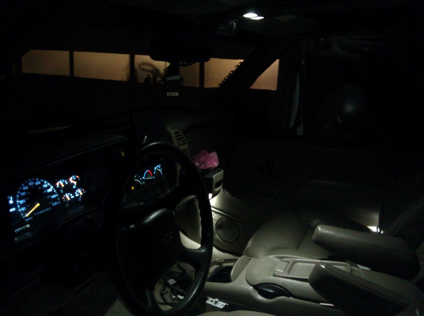

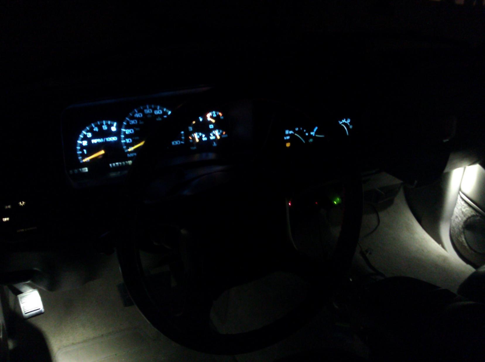

Just did my led swap for the interior, sorry I didn't do this sooner. Only one question though, is there anyway our are they all, dim around the 50 mph mark? Any way to fix it?
Sent from my HTC Vision using Tapatalk
Is it possible you got one LED in with reverse polarity?
Which brand & model LEDs did you use for the dash and in the door panels?
shakin
Oct 4, 2009
20
Atl ga
They are they cool white weld 6 from superbrightleds.com. I think its probably because I bought the cheaper ones, besides I want to change the now. I thought they were going to look bluish not purple. Oh well

Hmm. I think I may go with the SMD (surface mount) type LEDs instead of the WLEDs on mine and for my dad's '88. I was actually looking to do blue on mine but he just wants a brighter white for his. Not sure that cool white is what he's looking for. Maybe their "Natural White" would be better?
Your door panel lights look a lot whiter than the ones in the dash--are they the same, cool white?

Thank ill try them. The one in my doors and floor lights are white
