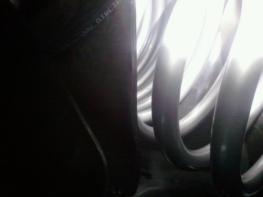

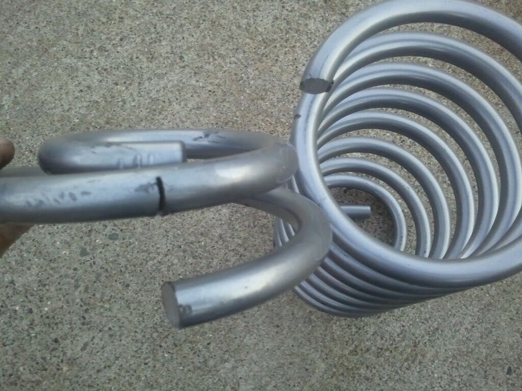

Done this many times on guys trucks over the years.
With the springs installed you will see 5 coils touching you can cut dead coils and will not change the ride. MAKE SURE YOU CUT THE SIDE THAT THE COILS TOUCH!!! NOT THE OTHER SIDE
Cut first 2 loops
Above cut will drop the truck about 5/8 to 3/4s. Remember if one side is higher ALWAYS CUT FROM THE HIGHEST SIDE FIRST because it will bring down the OPPOSITE side also. So of pass side is higher cut Above from that side first put back in and test to see if drivers side needs to be cut.
