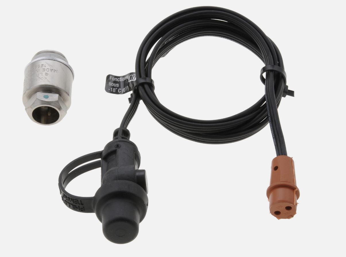

very much like the photo below and as already noted you can see the label/tag indicates 0'deg is when it turns on

their isn't any intelligence in the factory heaters...
when you plug them in, if you listen you can here a slight 'hisssssss' it's the element in the coolant getting hot
the vehicle has not idea they are on or off, they are just a heating element in the coolant

The thermostat is in the plug. My 2023 Tahoe didn't have a thermostat in the plug. It is just a regular molded plug end. My older Chev pickup had the thermostat. It wouldn't turn on until temp was -22C. I didn't like that if I plugged the truck in at -21C, the block heater wouldn't work. I cut the thermostat plug off and replaced it with a good quality electrical plug.
