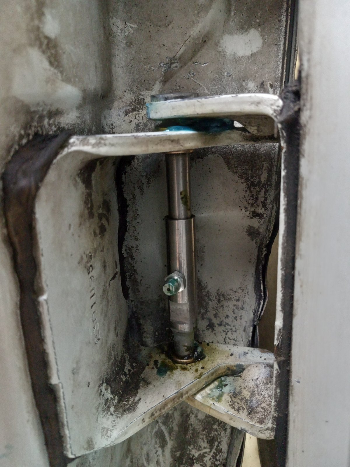

Here's an update, I bought the GM kit that I linked. Save your money and just buy a good set of pins and bushings. Kit works but it's poorly engineered. The bushings are nice and press right in. The pins are stainless and screw together in the middle. They are hard to screw together and the grease fitting deal doesn't work well. When you pump grease in it's supposed to flow through the pin to the bushings. It flows through the pin but comes out at the bushing with the least pressure on it. Obviously not the bushing that is going to wear the fastest and need the grease the most.

Here's the pics, this site is easy many sites you have to host to photobucket or another site and then download from there. I'm a retired boomer too.
