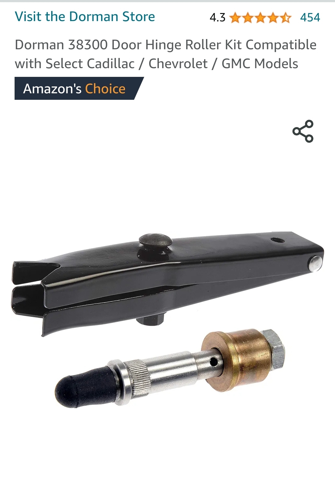

Hinge pins are a big point of failure. I've used a couple of these and the help quite a bit. And they're greasable.
